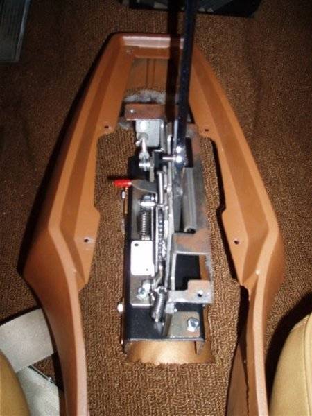

This is what you will find once you remove the console or top plate of the console. Loosen the set screw in the shifter knob and unscrew it to remove the top plate.

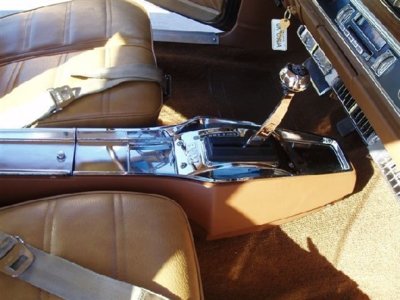

This was on my a-body Barracuda, but the concept is the same. I used a B & M Quicksilver shifter. I ended up using the B&M cover and mounting it on top of the factory console. I have seen others mount the shifter entirely below the console, so it comes up through the factory slot, but that puts the shifter too low to work comfortably, in my opinion.
Mechanic, thanks for the diagram, looks like what I have. Definitely will help me disassemble everything.
Cuda, yours came out really nice. That's what I'm looking to do, something similar. Is your shifter mounting plate mounted on top of the console or is the B&M cover only mounted on top? Thanks.
Cuda, forgot to ask, I assume you're using the cable to operate the trans now?
The mechanism is mounted directly to the floor, with about a 2 inch spacer under it. Only the cover is mounted to the console top.
