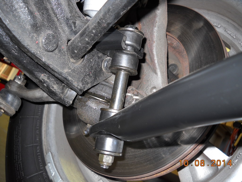

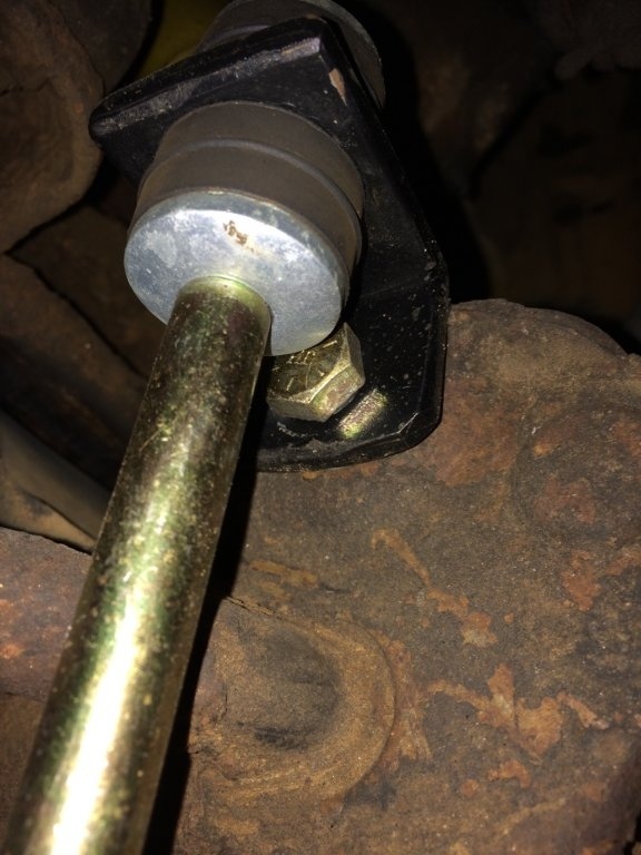

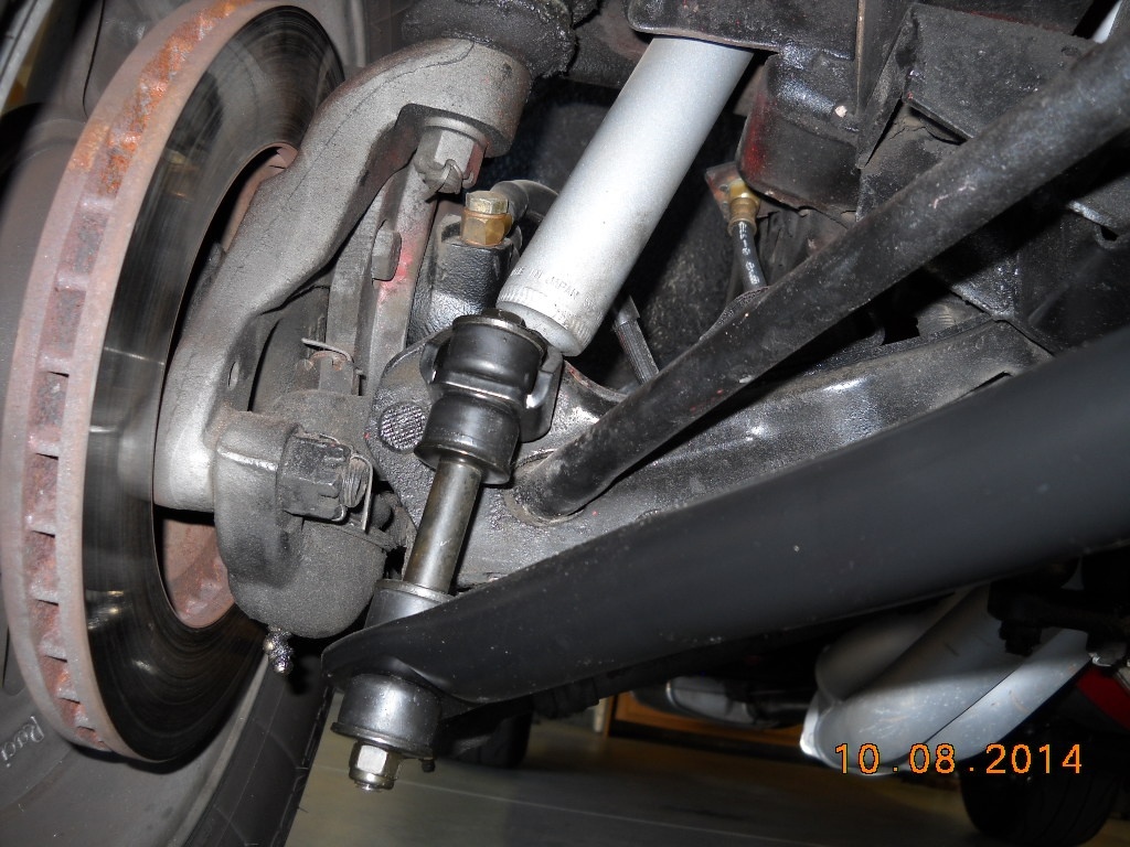

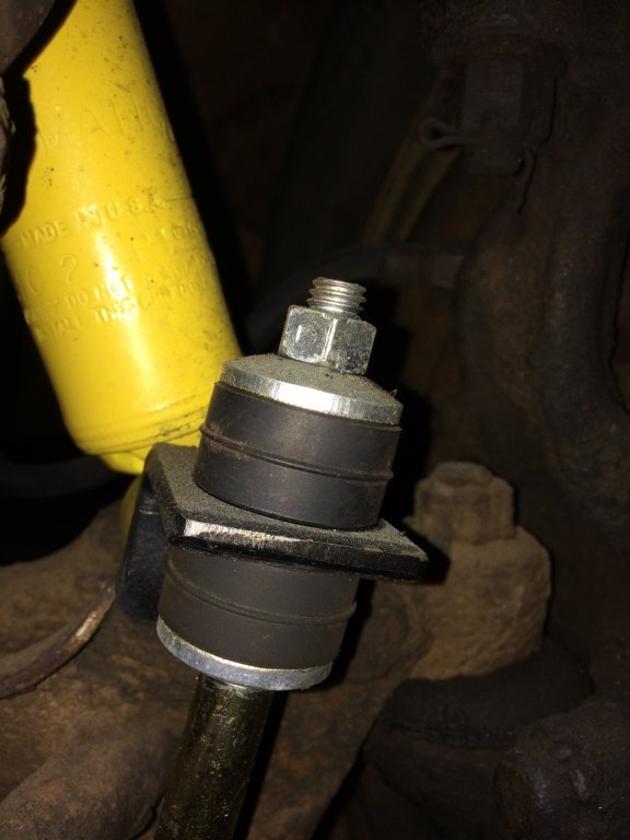

I would like to see how aftermarket sway bar tabs are installed on control arms that don't already have them. Does anyone have a photo they can post of how they've done this? Thank you!
Here's what I have done several times. What you can't see is a washer behind the L bracket to allow it to move freely on the lower shock bolt.
