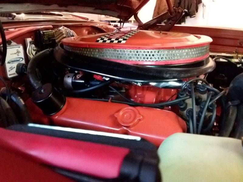

70 RR with factory Air Grabber and MSD distributor. The MSD Blaster coil is mounted on the passenger side fender just below the windshield fluid reservoir. The air cleaner base does rub slightly on one of the wires but nothing significant.
