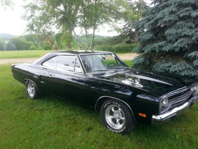

OK. Car was a factory 4BBL. Since it has had a 6 pack installed on it. I know the 6 pack runs on vacuum somehow.
Can anyone tell me what the factory switch location/look was for the car???
The air grabber on mine is currently non-functional, I'm trying to make it work proper and get a switch installed that doesn't look "hodge podge".
Any thoughts or comments are appreciated.

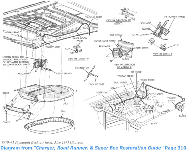

Thank you, thank you! This will have to do for now.....I think I need 25 posts to officially thank someone. :hello2:
Anybody got a picture of the dash with the original "air grabber" button? I want to make it as factory correct as possible.
One thing about the above diagrams is that vacuum reservoir location. For a 1970 Plymouth it should be on the firewall beside the heater hose outlets.
