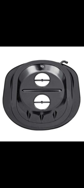

Air grabber base plate
Oh boy, 440 base but you’ll run into issues assuming your running a hi rise single plane. I use a Torker on my 383 and can’t use the factory CA305 Fram but the K/N smaller width replacement works great. More details on the intake and a spacer or not would help but the 440 base is needed for sure
Sorry just reread your induction setup. I would hope the 70 oval 2x4 would work but it’ll be close. Wait for others to chime in
I have a base from the engine builder but he only builds for shaker hood, problem is spread/spacing between carbs on the stage 5 intake.....I will need 2 base plates to build 1, so trying to make sure of the 2nd one to be correct for air grabber for the 70 air box. Possibly this one the black one ! The unpainted one is from the engine builder he is the only one that makes that base.....
