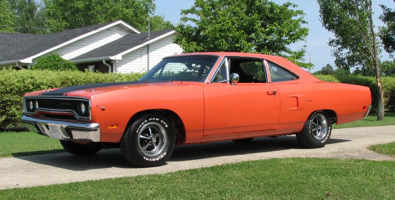

finnishing up my70rr and all i lack is the the air grabber.the under the hood parts are no problem.under the dash is what im not sure of . hose route? which hose goes where?where the seleniod mounts? is there any reading material out there?nothing in 70 manual.i would like to do a little research .can someone point me in the right direction.thanx IMG_2059.jpg

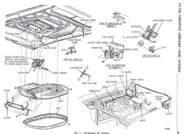

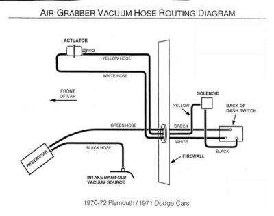

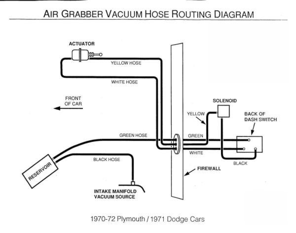

These might help also
