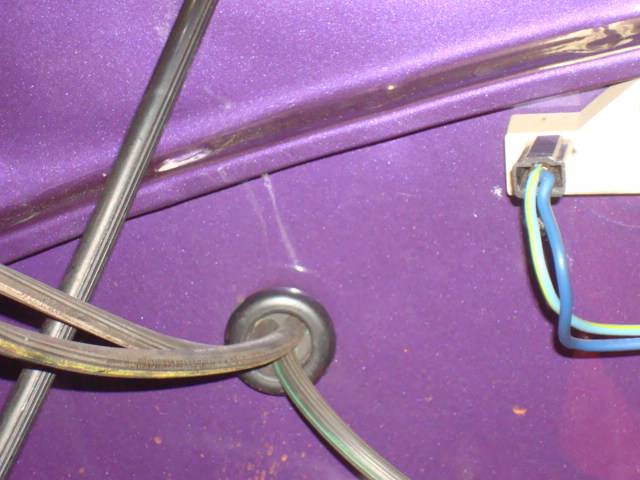

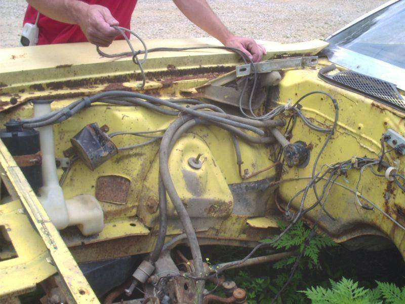

I know that my '70 has a three hole grommet for air grabber vacuum lines. (Picture courtesy of KiwiGTX)
A 3/4" hole in the firewall will fit this grommet.

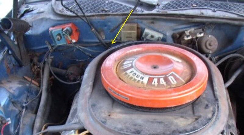

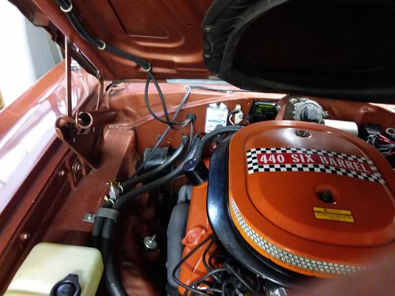

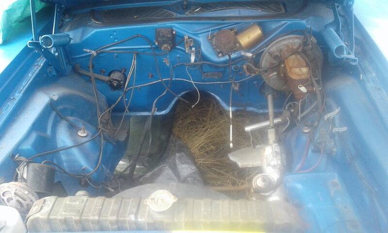

Thanks, guys! Am still needing to know where on the fire wall where the hoses/grommet goes
There will be a small dimple at the location to drill.
Nothing against ac and airgrabber combo. It’s just that the factory dimple won’t work. He will have to drill a hole a bit to the right of the ac hose, like you did.
