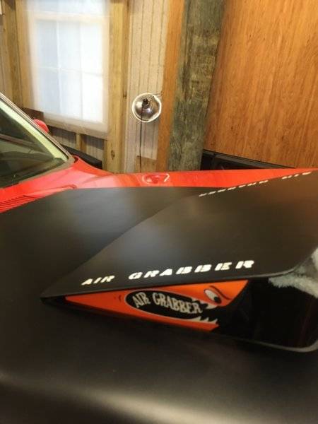

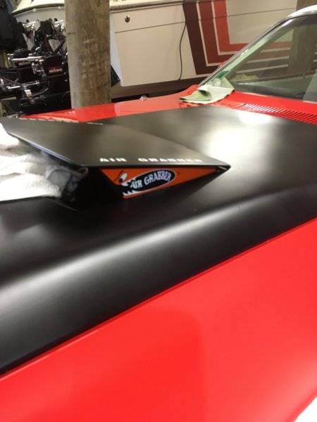

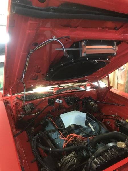

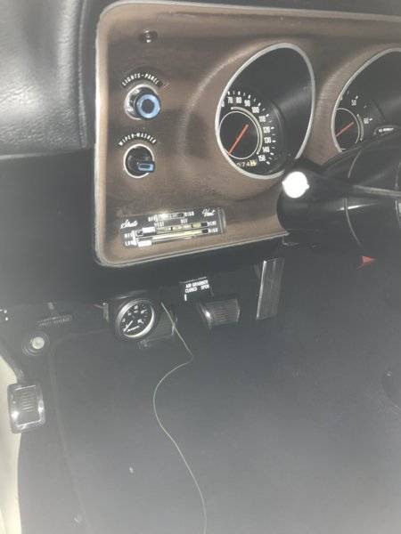

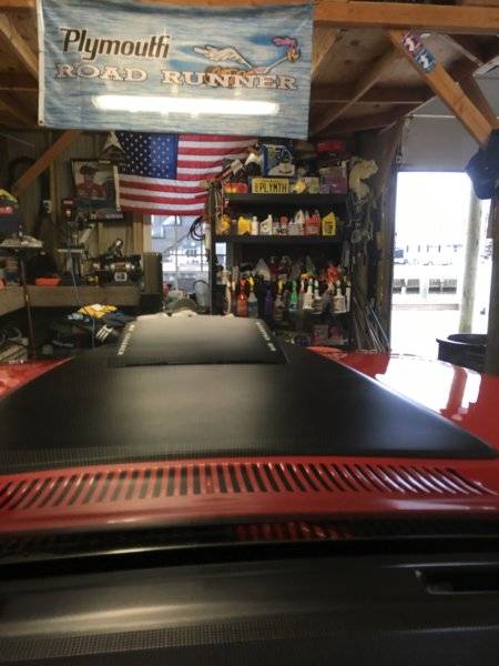

View attachment 743662 View attachment 743663 Well it's coming together finally. I just have to bolt the air box to the bubble , Ag door, decal on the door, actuator and hook up the green wire and I'm done.

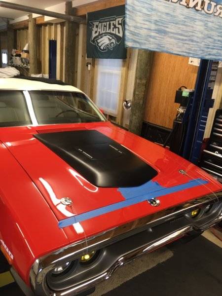

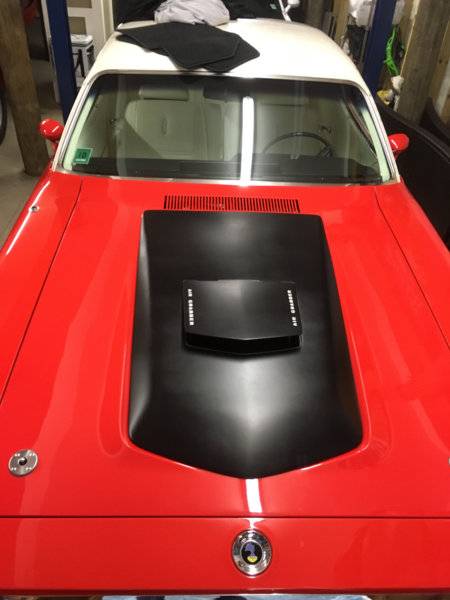

View attachment 743662 View attachment 743663 View attachment 743664 View attachment 743666

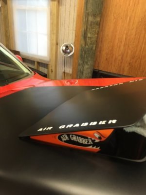

One problem, everything is correct according to mopar diagrams but when it move the switch to close it opens and open is closed. Check my connection over and over again with no luck.
Perhaps if you switch the vacuum lines on the door actuator or the vacuum switch. One of the lines is reversed. Good luck
