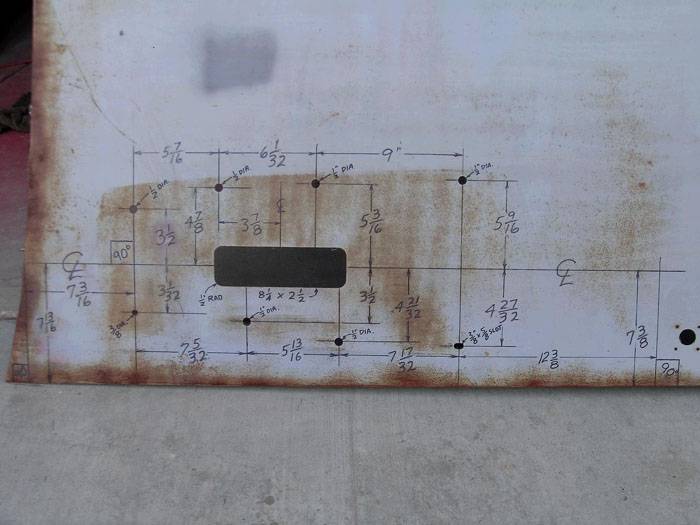

need help to make a airgrabber hood for my bee,i would like it to look like a factory job.If you know the measurements or the hows please let me know :blob1:
This seems to come up about every 3 months or so....
Courtesy of that "other" board.
