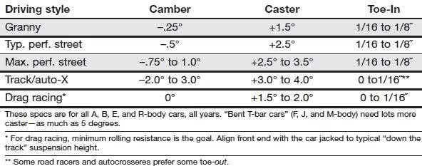

I recently purchased a 63 Fury and it needed a new right lower ball joint. I also replaced all tie rod ends and the torsion bars. Can someone please help me out with alignment specs? The car has a 413, radial tires and manual steering. It goes in for the alignment next Thursday and I would like to provide the desired specs to the technician. Thanks.

You will want different camber and caster specs than what is in the service manuals because of radial tires. Check out @Kern Dog 's posts regarding the subject.
Disregard the listed specs. I do mine at -0.5 camber, as much positive caster possible, 1/8" toe-in.
Shoot for these numbers. If you are using stock upper control arm bushings you'll just have to get it as close as you can.
