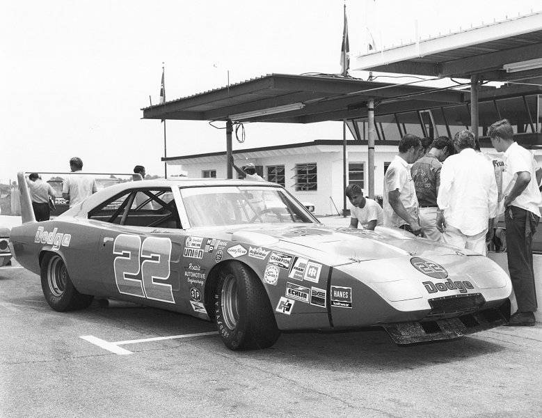

Here's the truth, with photos: ONLY DC-93 was at that test. See the 4 fasteners on the outside of the wing?
ALL the other Daytona were being converted from Charger 500s back at their respective race shops. (Rossi 22, Nichels 99, Owens 6, K&K 71)
See the pics!

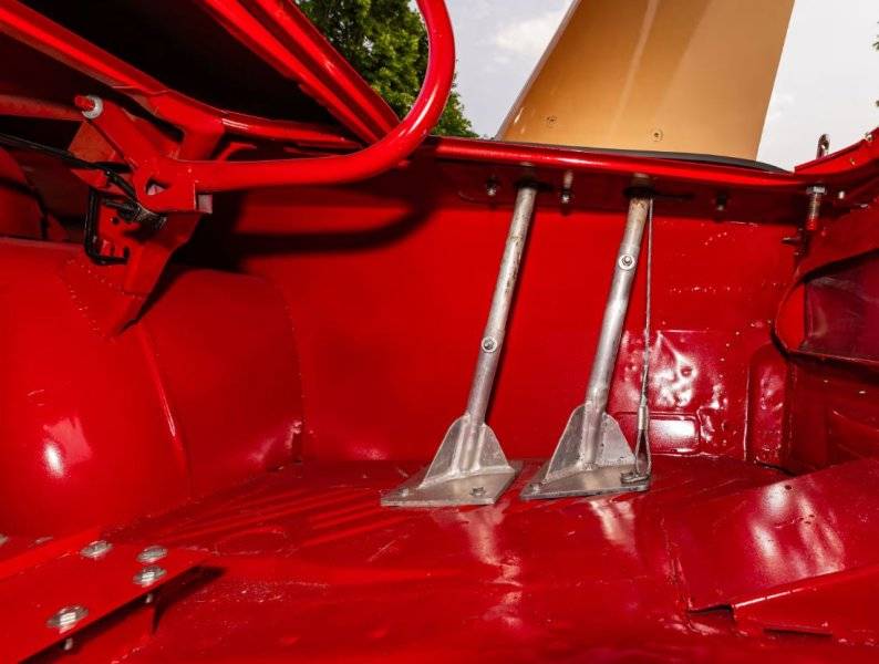

Door bar of the 22 clone should be lower on sill with torsion bar reinforcement actually going over the top a little.
It falls way short. Actually, the TB reinforcement looks like they used bar stock. A real one is purpose built from 3 pieces of metal.
Look beyond the shifter ball of DC-93. Zoom in on the cage bar and check out where the TB reinforcement is located on the bar.

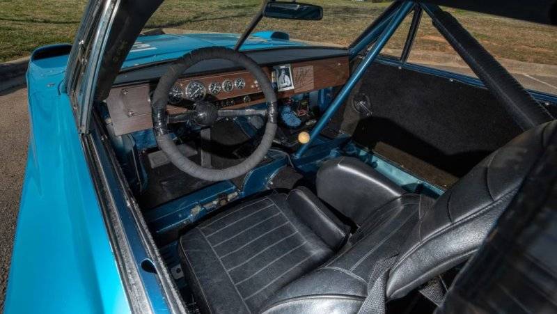

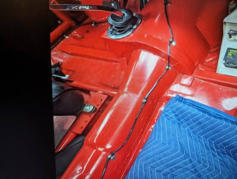

Rear Interior of DC-93 compared to the Allison clone car.
Look at the rear bars, where they 'land' by the rear shocks from the main hoop.
Look at the driveshaft tunnel. Red car gets close but no cigar.
ALL Nascar stock cars were required to have a full driveshaft loop.
View attachment 1910135View attachment 1910136

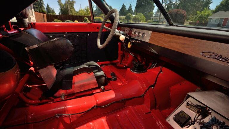

What's the story with the blower on the driver's side (circled in red); and there are provisions to mount one on the other side (circled in yellow)?
TIA
TIA
Rear axle cooler.
Other side would have a transmission cooler when used at Riverside.
Another detail missing on the clone tribute 22.
Rear axle cooler.

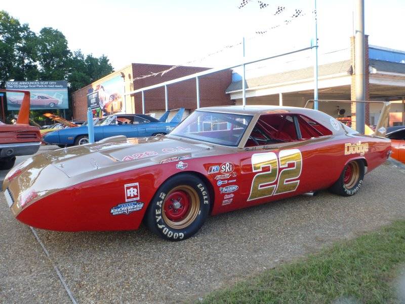

Construction techniques of the Fake 22 point to it being home made, which it is.
Pat McKinney never said it was real. There are vintage Wing Car club newsletters stating that.
