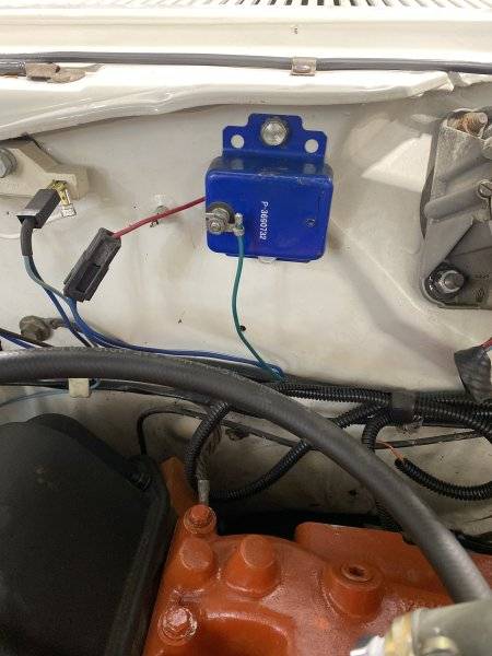

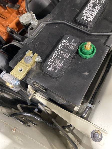

Went to the car show today. About 40 plus miles each way car runs great. Come home park. After a couple hours I come back out to move it in the garage and no start, just cranks. Give it another try and I see some smoke from the back of the hood. Oh ****, jump out and I have one of those brass battery disconnects with the thumbscrew .

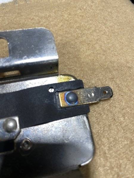

I see the fusible link is fried, I start feeling all the wires on the firewall. I touch the blue lead on the voltage regulator and it’s hot. It’s one of those cheap look alike electronic regulators. I check with an ohm meter and that lug is shorted to ground. I hate these parts. I replaced the fusible link, had an old mopar performance regulator in my stash, hooked it all up and car fired right up.
