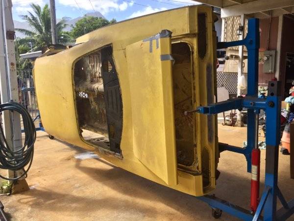

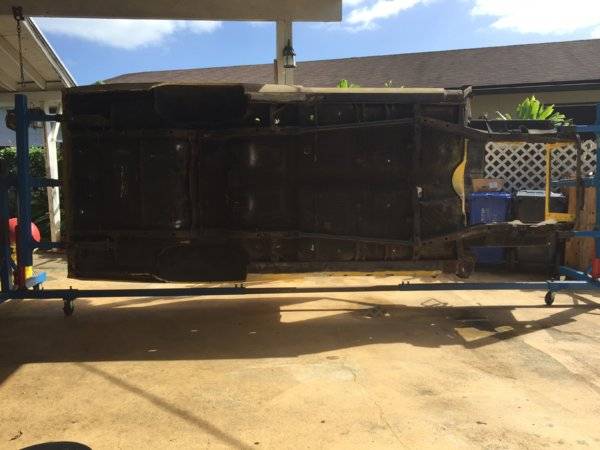

Yeah it’s on my rotisserie
AE3AA93F-31EC-4FE4-93A8-A1B500C047EA.jpeg D171C5D6-CF4A-4D23-9B77-D6B89BC8294A.jpeg
This will be a long term build. Gonna get it media blasted and then primer so the cancer will not continue. And just do what I can with some patch panels
