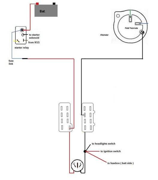

Good day all, my 71 has a 65 amp ALT with the 2 wire.we went for a drive last night. once it got dark and i turned on my lights all is fine until i get stop at a light all lights dim the alternator starts to discharge and the car stalls, bummer.the idle is set at 800 rpm in D.what is causing this every thing is 3 years old. thanks for your help.I dont want to be afraid of the dark lol.

voltage can go throught a hair even rusted, amperage needs a good quality and thick path and thats what your ammeter is saying. A batt is charged with amperes on a voltage rate, but still with amperes. You have a problem on the charging path between alt and batt, mostly sure at bulkhead... burnt, melted... and even maybe loosen, rusty, dirty ammeter studs. As mentioned, even with a damaged alternator, the batt must hold the engine spining. There is no a reason to stall the engine while batt is still there.
try to imagine this... two guys pushing a car. Voltage is the force every guy applies, amperes is the quantity of guys, resistance is the car weight along with some other factors like the road. Two guys applying same force will push better a car than one... The car demands some force to be pushed, so will demand more guys to push it. When getting closer to a hill, will demand more guys to be pushed.
BUT if the road is in bad conditions, won't be a way to push the car still applying the same force.
you are not getting amperage, and mostly sure also loosing voltage trying to keep the car and acc up... as mentioned, check the charging path between alt and batt...bulkhead, ammeter studs
ok got it, thanks for the help big time,its like 100 degrees in my garage lol will check what you said once it cools down.
ok just went out and check the bulk head connection was a little loose, push it in till it click, all is clean, pulled the red wire from bat to relay found at the end that should be red is back,the winding not good.could this be the problim
