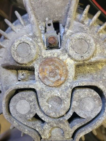

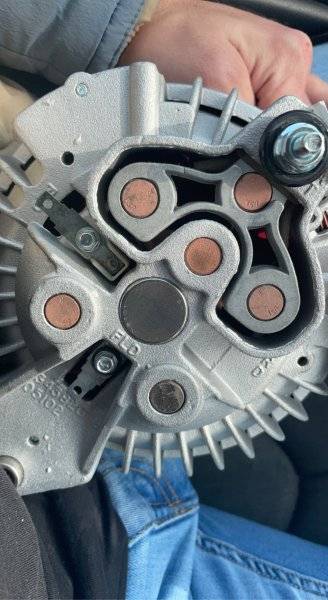

Having charging issues. Got a new alternator from Layson’s. Has two field posts on the back. Is this the right style of alternator? Does one need to be grounded to the case for proper function? If so. What gauge ground wire to use?
Points. Mechanical voltage regulator. ‘66 Charger.
Are both of the terminals isolated ? Or is that top one screwed to ground. Hard to see.

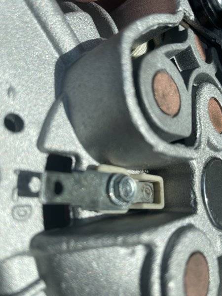

Fibre washers between screw and terminals
Looks like a dual field isolated.

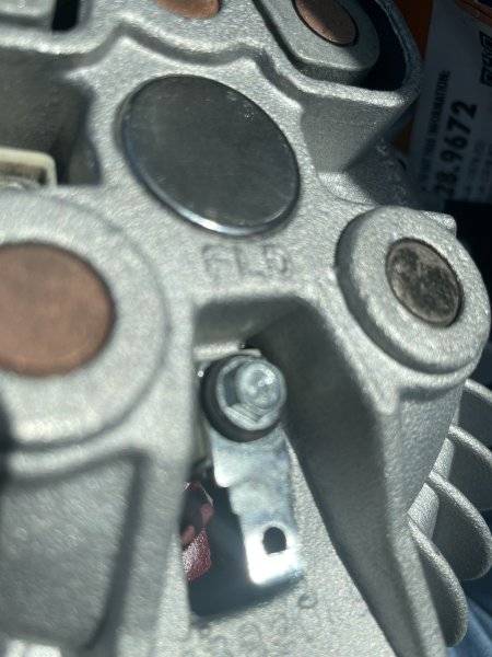

Okay. I spoke to a alternator rebuild guy near me for advice while I was waiting for replies. The left field terminal that I connect to doesn’t have a rubber spacer. The field terminal on bottom does. He said I can take the rubber spacer off the bottom and screw it back in and that would act as a ground, no wire needed. Is this true?
Yes, it's essentially bolted to the engine which is DC-com or Ground.
But I wouldn't do it that way.
One of them grounds. So you're saying you want to swap the grounded terminal. That would be ok. By swapping the isolating washer.

I see a number of issues:
1) Early single wire now a 2 wire field
2) Five diodes are gold, and 1 black (the 3 on the case should likely be black for negative)
3) is the correct field winding inside?
4) Seeing these issues, what else might be wrong?

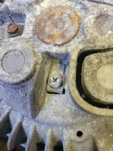

Here's an original 67 for reference
Çheck both field terminals for continuity to the case. If one is, then connect your field wire to the other one, and it will work. If neither is continuous then ground either one and connect the field wire to the other one.
better if use a washer to replace the isolation washer, for brush firmless.
On a side note... bend or clip off the prong you ground to save from conect accidentally there the wire coming from reg or will short out as soon you put the key in run
