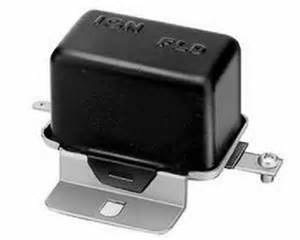

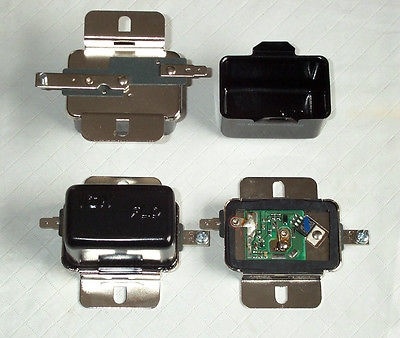

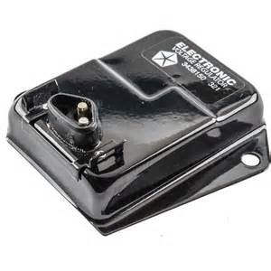

I think what 69a100 was referring to was a 70's style regulator. If you are using a 2 wire alternator you will have to use the 70's voltage regulator unless you ground one of the fields then you can use your old regulator. The first one is for a single field alternator(69 and earlier. The second is for a 2 wire alternator(70 and later)
That's what I ended up with. I flip flopped back and forth with the 1 wire and 2 wire and eventually decided on using these with a 2 wire alternator and 1 of the fields grounded. Looks original and working fine.
I ended up getting mine from
http://www.4secondsflat.com/regulator_tech.html

I have the mechanical on my 66.
The 71 and 72 Darts had the electronic style, and that's where I found the cheap one made radio noise.
