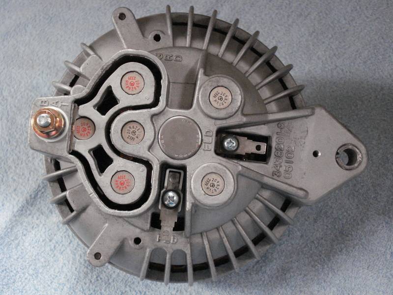

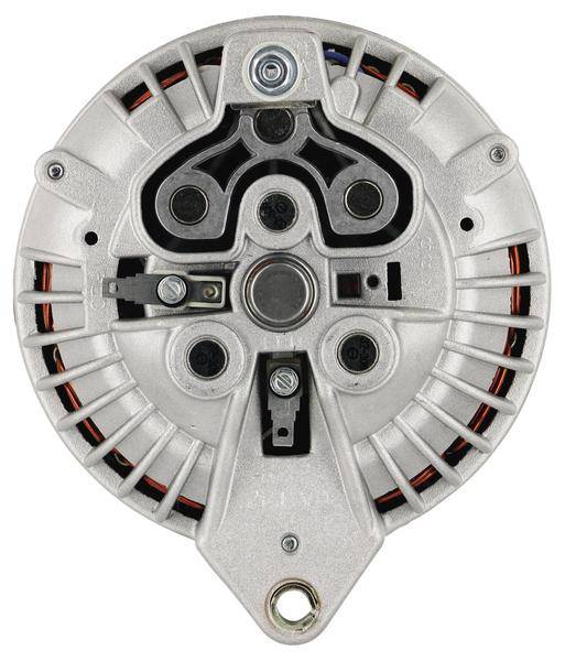

69 wouldn't be correct, they are roundback but still single field. 70 and 71 are still roundback but dual field
Should look just like this
Or this ( without the provision for the brush to be grounded )

Two spades are for STOCK electronic regulators ( two wires or fields to alt brushes. ). To be used on mech reg systems ( one wire or field to the alt brush ) one of the prongs needs to be grounded.
The ones pictured are ROUNDBACKS 2 fields, only used on 70/71. Since 72 a new one came out, called commonly squareback, on the same 2 fields disposition and works the same than 70/71 roundbacks. Reason for the names "roundback" and "squarebacks" are obvious.
There are some variations of this one too, but that's off topic to the thread
