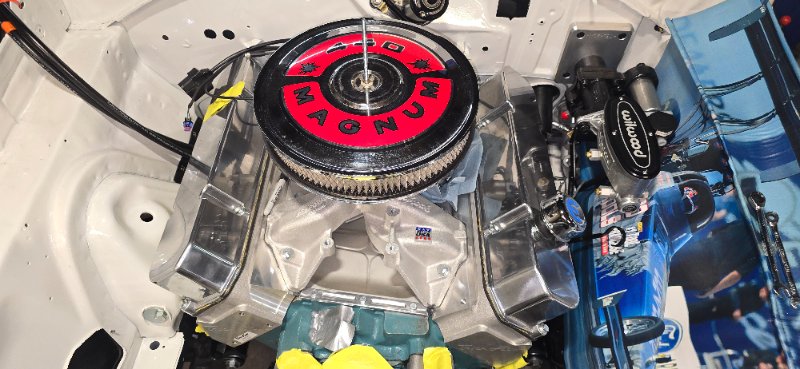

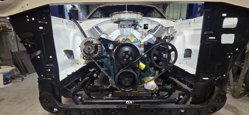

Hello B-Body friends. I'm new to the forum and did some serching but can't find the information I'm looking for. I'm trying to decide what alternator to purchase for my 1968 Charger build. I'm also looking for information on brackets needed for mounting of any suggestions. If possible I would like to stay with single V belt set up I currently have. Specs. 440 to 512 Stroker, TKX 5 Speed, Sniper 2 EFI, in tank fuel pump, Griffin Rad. with dual electric fans, Dakota Digital dash, Hyper Spark ignition system and finally Vintage Air AC system. I used an online amprage calculator and it recommend 152 Amps. Thank you all for any advice and help.

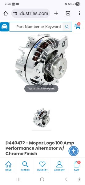

Ok, so I don't need 152 Amps. Good news. What do y'all suggest then? Would the one attached be sufficient then?
