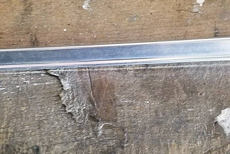

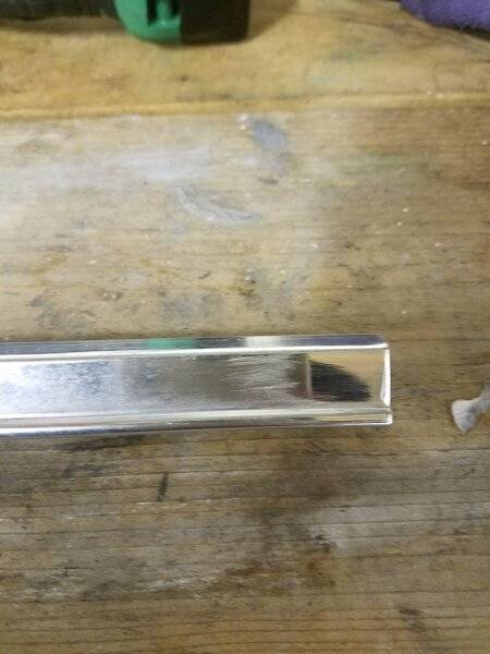

Hey guys, super excited to be apart of this forum and looking forward to the wealth on knowledge of these beautiful pieces of work. A couple years ago my father-in-law and I started to do a light restoration on his 1966 Charger. He gave me all the trim pieces when it was off at paint. Most of the chromed stuff cleaned up good, but the aluminum trim that goes along the entire car was in rough shape. The anodized finish was oxidized and when that happens is impossible to polish out. The only remedy for this is to strip the anodizing off to get the trim down to raw aluminum. This was accomplished by using a lye solution and was dipped in for about 5 min on each piece, and then rinsed with water. From there the prices were wet sanded by hand with 3000 grit and and then polished by hand to a chrome like finish. This trim is much easier to maintain and polish since it is raw aluminum and in my opinion looks much better. Check out my video on youtube for a short tutorial here
Very NICE! Do me a big favour and take that ring off before you get anywhere near a power buffer!
Thanks man! Yeah I've been doing this for a bit and when I run a polisher my left hand is on the guiding end. If you have instagrM my handle is @trillosautodetailing
