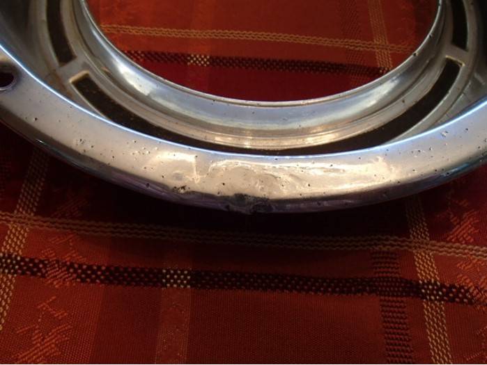

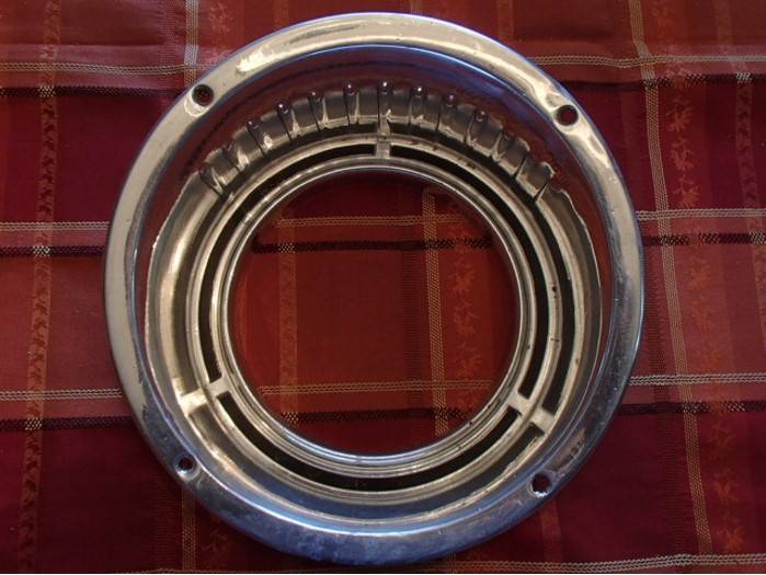

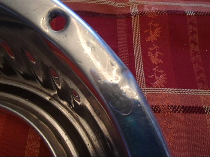

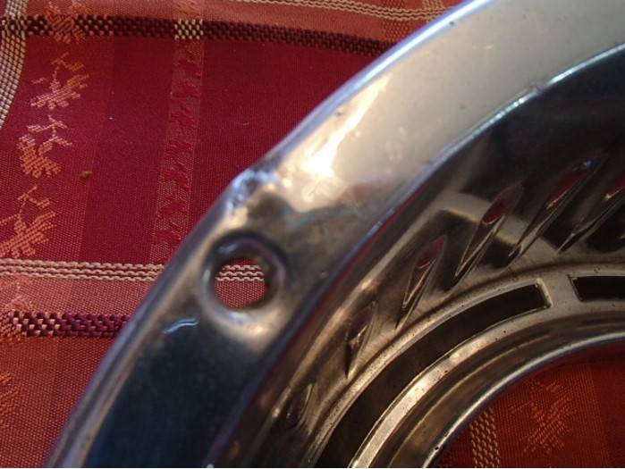

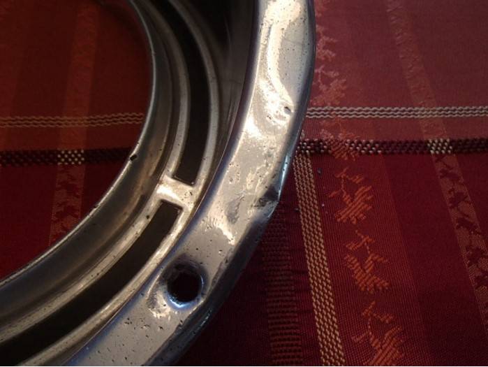

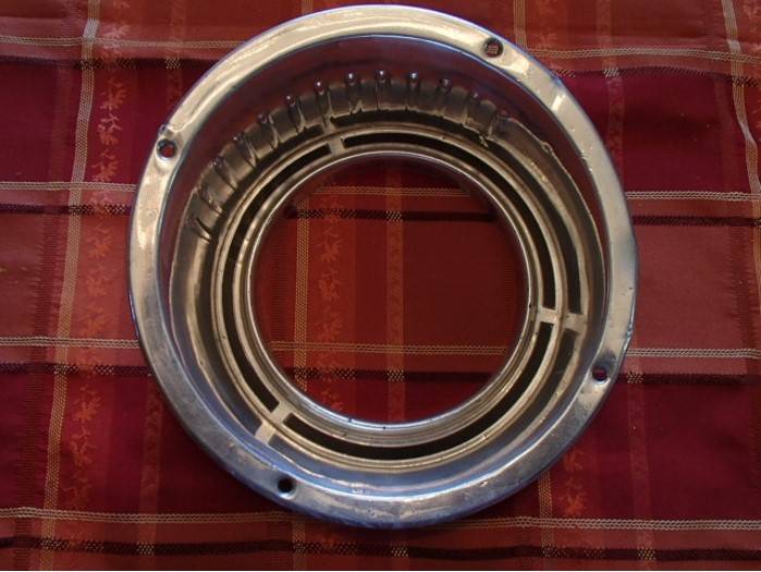

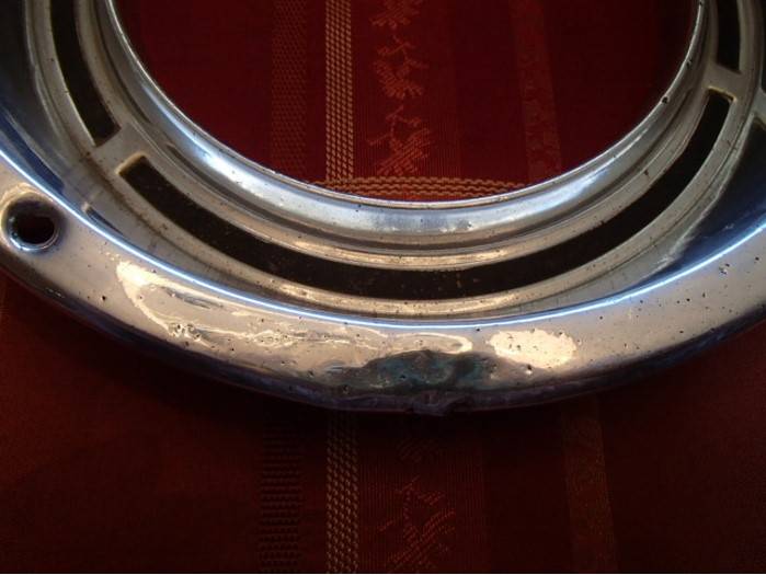

My 62 Plymouth outer headlight bezels are a mess. Open to Any suggestions out of the box ?
Here's the thing with those pieces, the factory anodized them. It's a thin crispy coating that is very hard. You can't file or sand it and bring back any finish. All you can do is remove the anodize useing this proceedure explained by member Malex in my build thread, starting with post 401...
https://www.forbbodiesonly.com/moparforum/threads/taking-up-new-residence.114133/page-21
Then you can hammer out the dings, reshape with a file, sand with 220 and work your way up to a 600 to 800 grit, then polish with compound. (I show and explain this doing stainless in my build thread also. Go back a page from the above link) That will be good enough for a driver. If you want something better, you'll have to look for a good set without having to do all the work. They're out there.
I have a feeling they would look worse when I was done with them. I was thinking about some body filler and chrome paint
