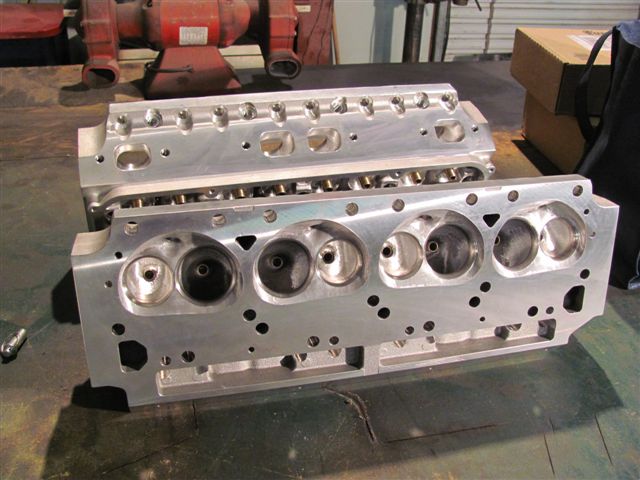

My 67 Coronet street car is running Edelbrock Victor heads, ported by Cody Laroy, flowing 343 @ 0.700" :headbang:
