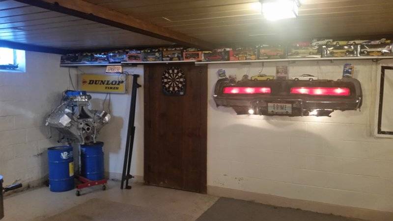

I have two old windowed KB blocks at home that still need repaired someday. The quality & how heavy duty they appear are much more superior compared to an Indy block. Plus, they won't have all of the usual quality & complaints every has once buying any Indy product. Here is one of the two.
