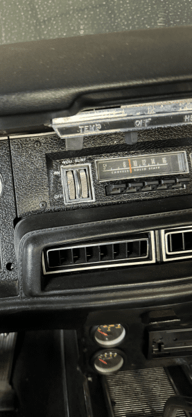

Where can I download the AM radio service manuals to try to repair my 1969 Dodge Radio?

This is the AM Radio. I dont know the brand or model

Then ask if anyone has a copy they can scan. I have a few I might be able to help you. I will need a model number. As mentioned by others, the two manufacturers are Motorola and Bendix for MOPAR.
