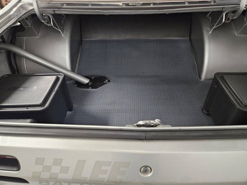

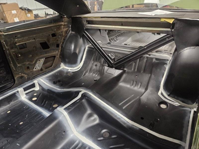

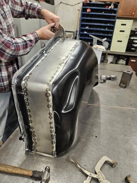

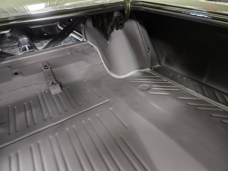

luv the 3" wider AMD inner panels
on some builds where I need to stretch the opening for much bigger rears, I've used trailer fenders back to back. Being a Mopar guy often requires us to be resourceful
