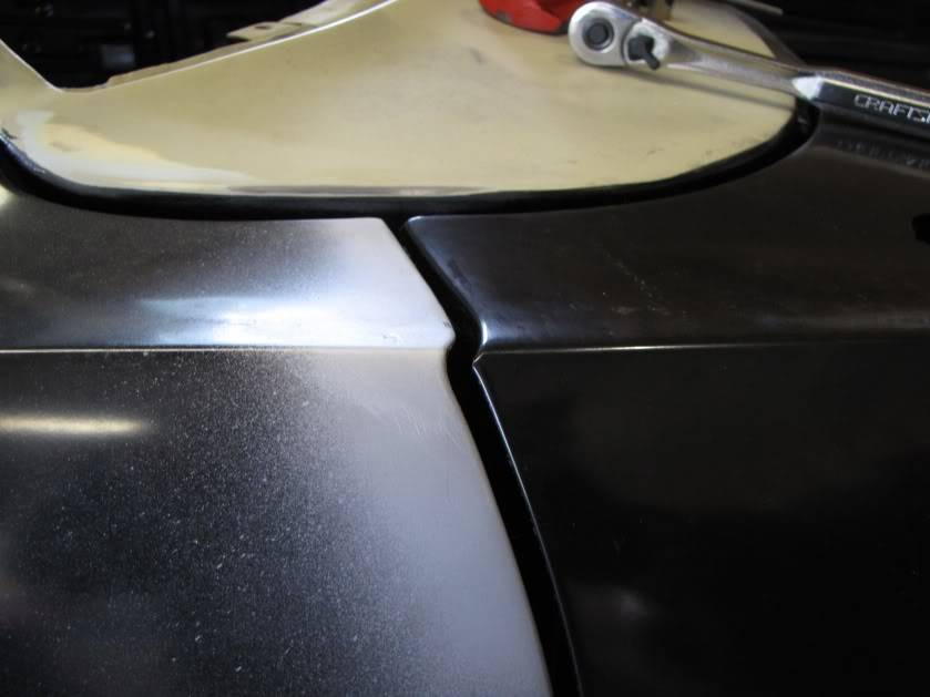

AMD doors and fenders are now back on my RR. Below are some pic's of the fit up at the top of the doors/fenders...The panel with the yellow paint marks is the door, which needed work to look/fit right. The new AMD fenders had the factory correct curves when compared to my coronet's original fenders.
Also, at the last 3" vertical inches of the leading edge of the door, it curved out and had a screwy gap there. Nothing a high speed sander, file and some 100 grit couldn't cure. Myself, I wouldn't just plan on bolting on the doors and calling them good. I guess it all depends on how picky you are.
Hope it helps..

Prop, thanks for updating my post. I had been following your restoration thread and had seen the pictures. Hopefully the drivers door and 70 air grabber I will be ordering won't have the similar issue. I guess everything out of the China factory is a little different. I had seen the fender pictures and the chunk you took out of it to fit correctly. I will prepare my grinder and welder for the new parts arrival. Looks like your project is getting closer to paint. good luck.
