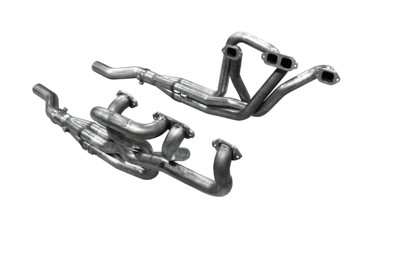

Geeze for 1700 bucks you would think the flanges would be even. Look at the flanges where they hook up to the head. Not even close to being straight. I'd spend the money on TTI or Hookers.
I completely agree and seeing how the flanges were not even is one of the reasons I started the post. I searched the forum and didn't find any information on them.
The only reason I started to look for stainless headers is because of the wording I pasted below that TTI has in their Maintenance/Care/Warranty document. I plan to keep my car for a while and would like a set of headers that are going to last and not rust for years. The wording below is from the TTI document section on storage and possible moisture from below the car causing the headers to rust. My concern is there are plenty of other times water can and will get in between the header tubes and start rust if they really are not all coated between the tubes.
From TTI Document: Then coat the headers with WD-40 or an equivalent where the tubes are welded to the header flanges and where the tubes come in close proximity to each other (especially where the four tubes enter into the collector).These areas are prone to rusting, as the coating is unable to get between the tubes in the unexposed areas of the header.If rust occurs, it will travel into and under the coating and create a stain.

$1700 is a lot of money.
The reason the flanges don't line up is because the pipes are separate.....the collector slips on to the individual pipes. They just didn't line them up for the picture.

I have an ARH full system on my other car, they are excellent. Great build quality, excellent "merge" collectors, primaries within a 1/2" of equal length. That's one of the reasons I chose to spend the extra over TTI's. If I'm spending that much money, they should at least be "close" to equal length. TTI's, as with most other headers, aren't even close.
