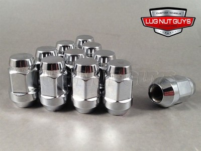

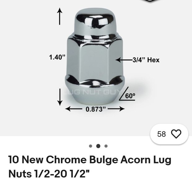

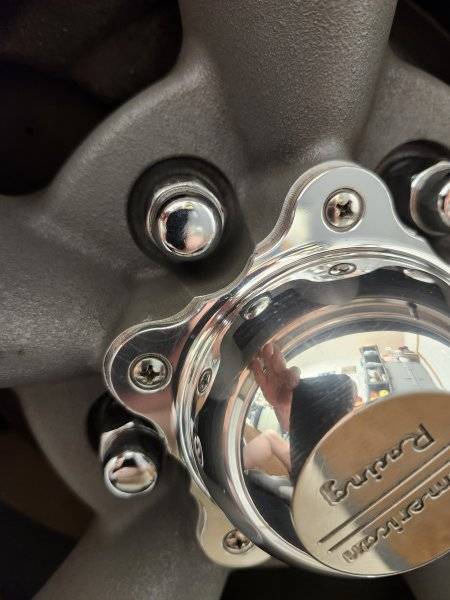

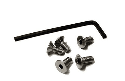

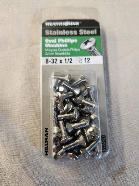

I just mounted the exact same wheels 2 months ago and used these. They also come in LH thread. I also ditched the hex head center cap screws for #2 stainless phillips. Much easier to r & r.

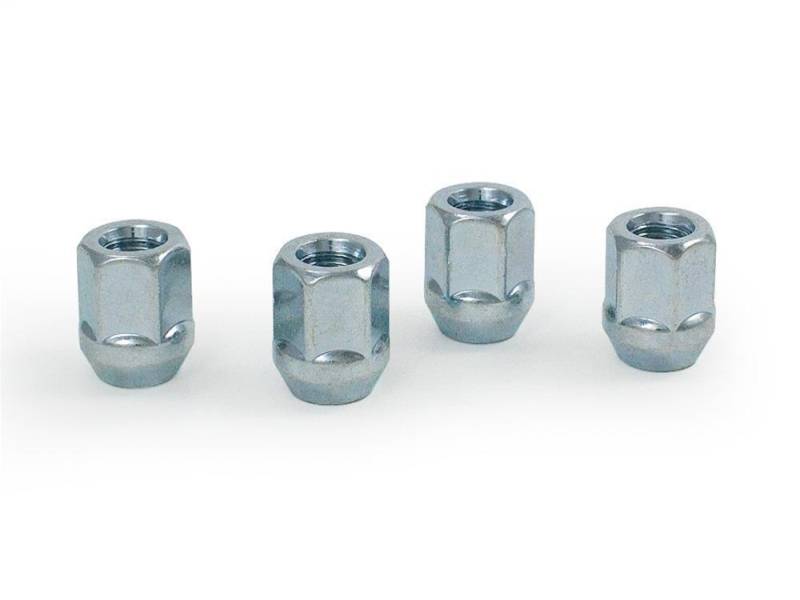

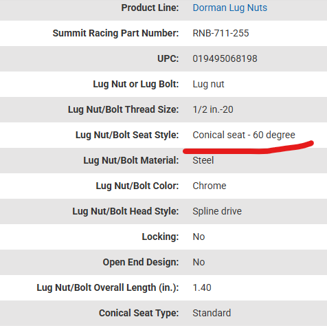

I bought Summit Racing brand conical set for mine. Lots to choose from. No extra length studs required.

Blue Loctite the threads on the center cap screws if you want to prevent one from falling off. Ask me how I know.
