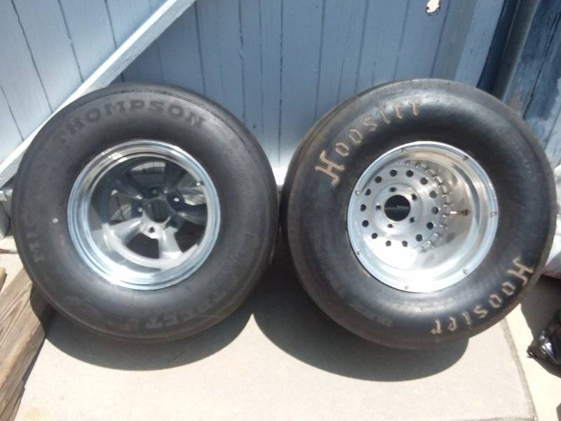

I don't know if you are looking for new or used. I don't know if they ever made 15x12s in the old days, but currently 15x12 is a custom order two piece wheel only.
I bought some beautiful like-new one-piece 15x10s, the biggest one-piece they currently make, but the backspace wasn't right (one piece has no options, there is only one bs) and they just weren't wide enough.
I ordered custom two-piece from performance plus in Long Beach, ca. They ran just over $700/pair,and took about a month. I thought that was reasonable for a custom wheel. Bunches less than my friends racelines, or beadlocks.
They are probably more money now, maybe cheaper at jegs or summit, but I wanted to use a local company to make sure the order was right, and performance plus is "world famous!". TT2 on the left.
