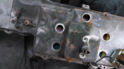

Here's a cluster that came to our shop for a voltmeter conversion, as you can see there was a fire when one of the ammeter stud's came loose and shorted out on the housing, the insulation started to burn like a fuse....until the battery was disconected. This is a Mopar owners worst nightmare. IMG_20131028_133539806.jpg This cluster is out of a '67 Plymouth Fury.
There's an extra wire added to that ammeter. Wonder if that modification had anything to do with the fire? :eusa_think:

Here's a cluster that came to our shop for a voltmeter conversion, as you can see there was a fire when one of the ammeter stud's came loose and shorted out on the housing, the insulation started to burn like a fuse....until the battery was disconected. This is a Mopar owners worst nightmare.View attachment 148639 This cluster is out of a '67 Plymouth Fury.

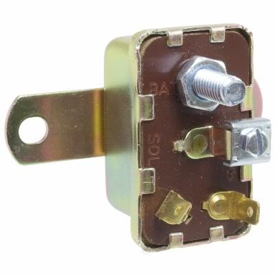

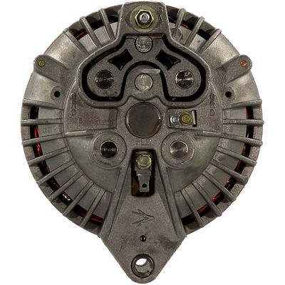

you can run a wire from the main 12vt output charging threaded terminal to the big threaded lug on the starter relay, that's on the firewall by the bulkhead connector, that helps some, to reduces/lessons the strain/load on the under-dash wiring, the large black wire that branches off & that feeds all the under-dash fuse panel & dash/gauges wiring etc., it helps allot & shortens the current & charging path... I've done it with an 6ga.- 8ga. wire in several of the B-Body cars, I've owned with larger amperage alternators {like 75amp & above, it's a Band-Aid, but will help} & that still also had the original Amp gauge in line & working... I always clean all the connections on all the bulkhead connectors, & add a dab of dielectric grease to all electrical connections, resistance equals heat, get rid of the oxidation/rust {on anything I do in the electrical system or added electronics stuff} including the back of the amp gauge... make sure the wiring is all in good shape, no cracks & all good connections, no loose ends... I also will sometimes add some shrink tube to the wire connection for added safety & a little peace of mind, the original connections are just taped...
I did a very easy fix when my dash was out. I went to the hardware store and got some plastic spacers, drilled the ID out a little bigger and cut them off so they are a little longer than the metal frame that surrounds the terminals. So now there is no way a terminal can short to the frame no matter how I pull and heave on the harness. Simple, cheep and easy. This fix will last a lifetime and I can use the original guage without reading schematics or rewiring
clarification
you can run a wire from the main 12vt output charging threaded terminal {on the Alternator} to the big threaded lug on the starter relay, that's on the firewall by the bulkhead connector, that helps some, to reduces/lessons the strain/load on the under-dash wiring, the large black wire that branches off & that feeds all the under-dash fuse panel & dash/gauges wiring etc., it helps allot & shortens the current & charging path... I've done it with an 6ga.- 8ga. wire in several of the B-Body cars, I've owned with larger amperage alternators {like 75amp & above, it's a Band-Aid, but will help} & that still also had the original Amp gauge in line & working... I always clean all the connections on all the bulkhead connectors, & add a dab of dielectric grease to all electrical connections, resistance equals heat, get rid of the oxidation/rust {on anything I do in the electrical system or added electronics stuff} including the back of the amp gauge... make sure the wiring is all in good shape, no cracks & all good connections, no loose ends... I also will sometimes add some shrink tube to the wire connection for added safety & a little peace of mind, the original connections are just taped...
Just for clarification... it's the big threaded terminal from the Alternator 12vt main output, to the starter relay large threaded 12vt main terminal on the relay, if there was any confusion... the 1st sentence was kind of worded poorly
