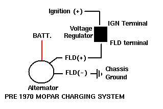

Maybe this will help you.
http://www.mopar1.us/charge.html
Mopar Charging Systems
  • up to 1969
    Diagram #1 shows the basics of the early alternator / voltage regulator (VR) design. There are 2 brushes in the alternator, each one has a field terminal, one is labeled "FLD", the other is labeled "GND". The GND brush is grounded with the brush mounting screw. the other brush is the (+) brush (or field) and attached to it is a green wire that routes over to the voltage regulator (which is behind or near the brake master cylinder) this green wire is connected at the voltage regulator at the "FLD" connection. The other connection on the regulator is a blue wire with a female plug end. This is the "IGN" Ignition side.
    Basically, the voltage regulator completes the charging circuit and allows the alternator to charge the system. When a certain preset voltage is obtained, the regulator "opens" (or turns off) the circuit until the electrical system's voltage drops below a certain point, then it turns on again. The old Voltage Regulators are repairable and rebuildable. The 1969 Dodge Shop manual (available from Year One) details how to do this. If you think your regulator is failing, open it up and clean the "points" with some emory paper or light sandpaper. Sometimes these points get corroded and this stops them from working.
    NOTE: in dia. #1, the FLD is generally green, and the IGN wire is Dark blue on stock Chrysler wiring harnesses.
    dia. #1
