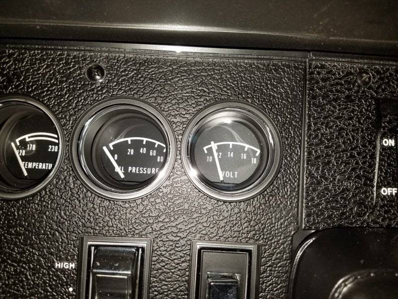

Here is a pic of my current project with the new volt meter instead of the amp gauge. Guess it would help if you posted what car you are working on. #6 wire from the alt to the bulkhead fusible link is what your car came with from the factory?
Negative that was the gauge of wire that was used in the rewire done by Mopar muscle magazine. I am doing this on our 66 Satellite they are the small and rectangle gauges. So if no one can do it by converting ( using the O.E gauge itself) , I will try and build my own dash cluster, then stand back and look at it saying " you freak'n idiot. that's really ugly" Then have a custom replacement done. At the same time move some of the gauges from the cage bars into the dash. There is no hurry as I can always do the rewire, by pass the amp meter, so car is done ( want to up grade the hood and body harness any way). and do dash stuff later. Which is why when we think we want to sell we keep it ( explained elsewhere on this site). PS: does anyone else have trouble with the WRX clowns who think there cars are quick?
