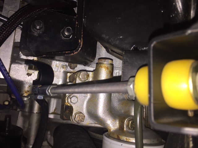

Under 1962-1965 look for (Make your own toque strap) it's all there
