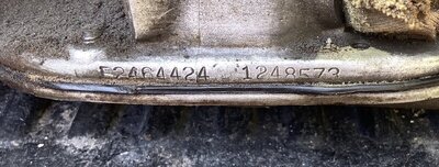

Hey all, i usually hang out on the a-bodies forum, but i figured this was a b-body question. My buddy came across a big block, push button trans and we are trying to figure out what it came out of. Any help would be greatly appreciated!!
Heres the numbers
E2464424 is from a 1964 361/383 727 Medium car. Imperial
1964 B-body 383. Not console shift. from GG White book
Not imperial
