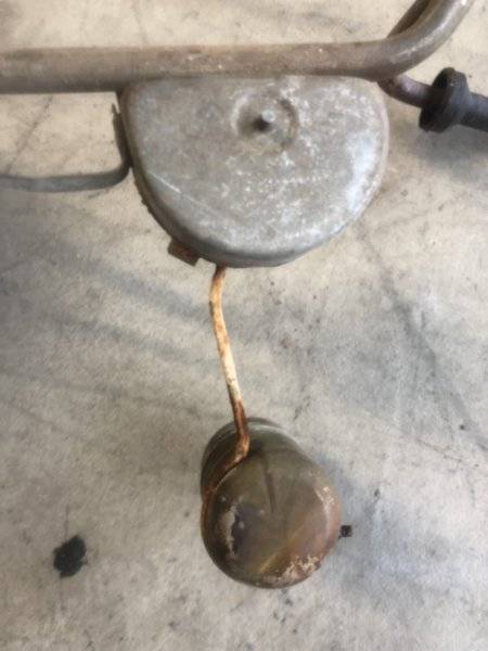

I have one out of a 69 Bee that needs to be rebuilt if your interested.
$20

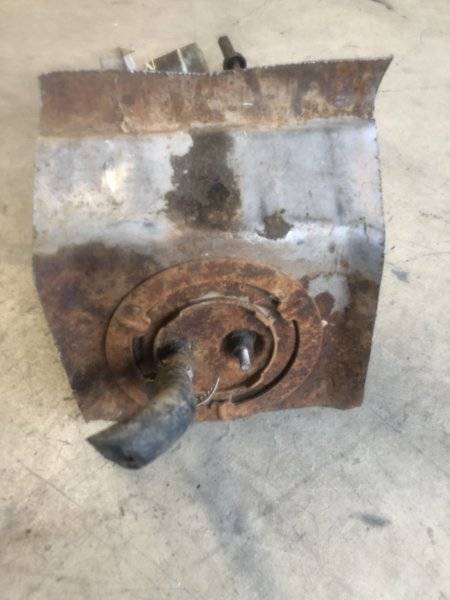

I went with EFI. I have never used this. I cut it out of the tank before I trashed the tank. It will need to some soaking to get the snap ring out.
$20 + shipping

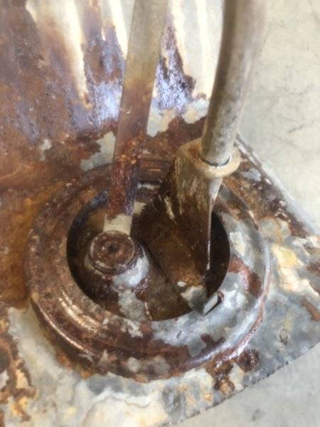

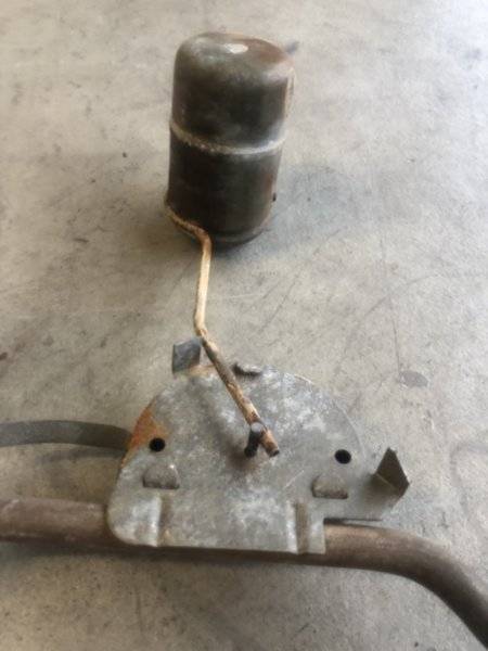

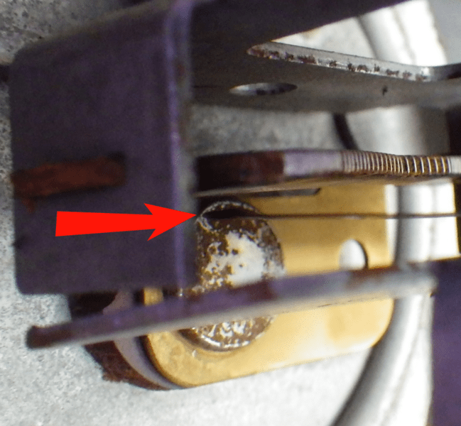

A little hard to see in this picture. I'm not sure but I believe this old Abody sender failed because a contact came off the sweep arm end or maybe the arm is just bent away from the windings. I don't know how originals were made. Anybody know??..…….
That little brass arm should have a little round dimple pushed into the end of it where it contacts the windings. I've seen that dimple get a hole rubbed into it so it doesn't contact the windings anymore
