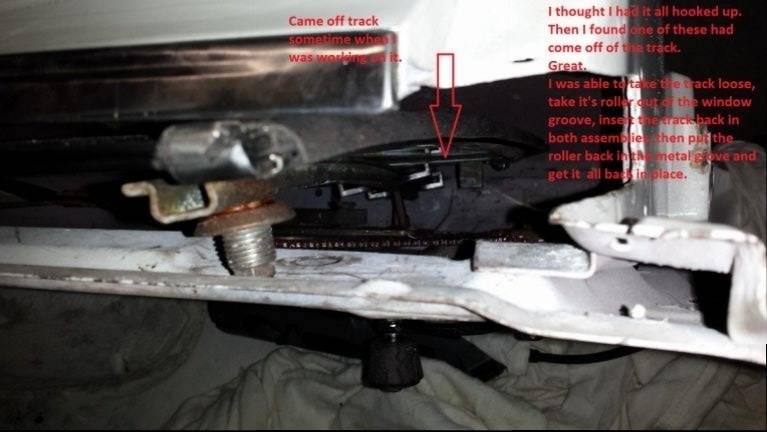

I got my second quarter window installed, It worked good, But when I was putting lubricant on the tracks I noticed the top triple roller was off, Is it possible to install the forward track and rollers with everything else in place? I really don't want to pry off damn clip again. Thanks for all your help!
You talking about the yellow arrow?

I have both windows in and adjusted, I'd like to thank everyone for there help !!!
