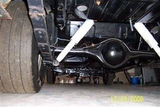

65 Dodge
15x8-4.50 BS, Its close
No tub
No springs moved in- No cuts
