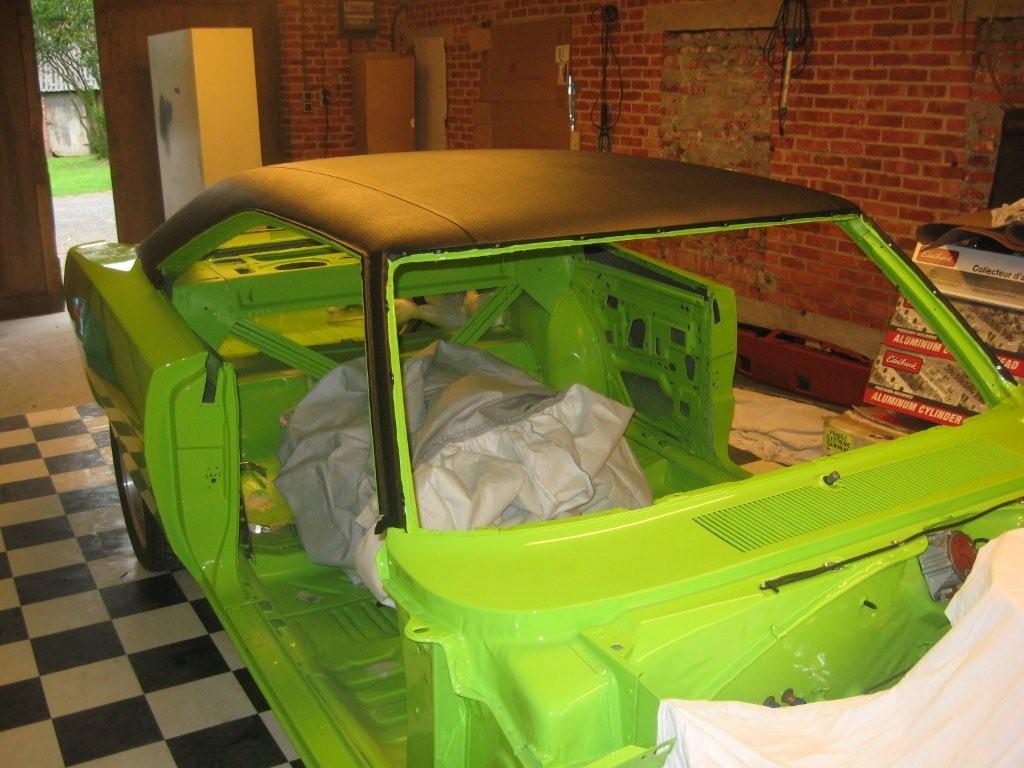

Got the roof done:) 3 1/4 bottles of M superglue and a lot of patience.
Hardest part was NOT to get glue on the vinyl that shouldn't have any during the spraying. Also trimming and cutting afterwards was timeconsuming.
Now is the big question how to get the driprailmolding over the seam
on the A-pillar?:confused:
Per
Looks good.
It just pops on. I've heard there is different trim for vinyl Vs non-vinyl, so if your car was originally a non top car you might have issues.
I checked it out with one of the supposed mopar experts who sells parts and he said there is only one set of trim vinyl top or not.
My skill with fabric is weak enough I have a guy do all my stuff like this, I've helped him and learned a little. the number one thing he says you must do is used the right glue, he used a high temp contact cement and sprays it through a paint gun.
In the time there were 2 different moldings but todays repop are made
after the vinyltop moldings but it should work with the original non vt.
