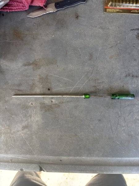

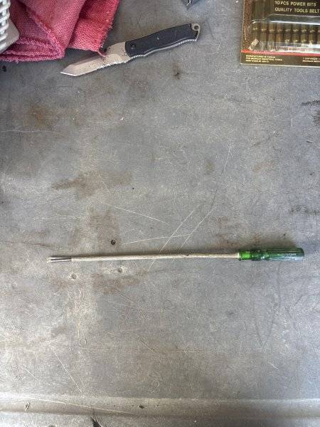

Found this cleaning up
screw starter...sliding the sleeve down slides the 2 halves of the blade over each other, making them wider to grip the walls of the slot...you really couldn't tighten anything with it, just hold it to get it in place...they made phillips versions of these also
Quick-Wedge Screw-Holding Screwdriver?
