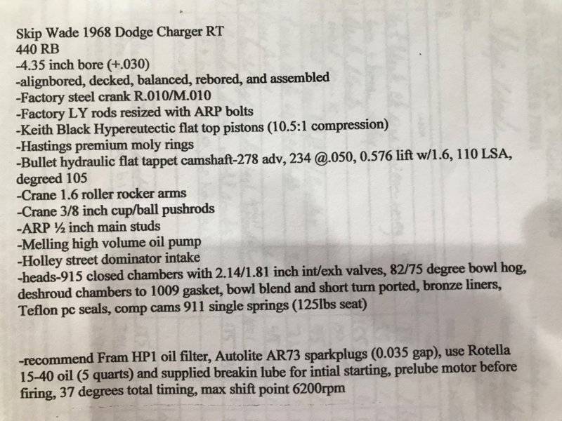

No sir. I am going by what my new reputable builder states. He won’t push a motor past 30 over.
$5500.00 all in on this build...FYI
yeah 7200 for a short block is nuts on a 440
Just called Hughes and explained the build he’s proposing. They said he’s right in the ball park on the cost. I will post exactly what he emailed me and list it out for you guys to pick apart.
Like I mentioned in another thread....SONIC test the block and see how much meat is on the walls. Heck, any block should be sonic tested before boring. The thought about not boring any block past .040 is asinine and is way beyond 'old school' for any machinist that's worth his salt!! It's obvious your machinist is stubborn way past his prime as a machinist. Tell him that comes from a machinist with over 30 years of experience! Find another builder that isn't going to cost you more needless money.....
$7200 for a 440 short block? That's a bit steep.
.040 is done? Some blocks .060 have more meat left then one at .030 over.
Sell it...someone won't be afraid of it.
