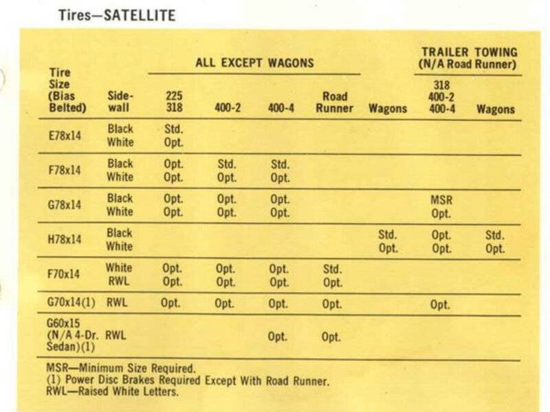

No expert, but interested in the numbers. Something is wrong. 1972 didn’t use that tire sizing they used alpha-numeric, F70-14, etc. I don’t find a 1972 decoder online, only 1969-71, the 69-71 decoder shows those for 69 only.
Here is what the 1972 specs and data book show.
83646473-77A7-4C16-AB79-926EF8F770F2.jpeg C31C3270-17E6-4EE0-A625-E7DA1361EEB1.jpeg 56698A05-A426-4948-BE4A-A0623B9AE1AC.jpeg
Thanks. My fault. I wrote it down as U52. It's actually J52, which is inside hood release. That explains the weird tire sizing.
So, with that figured out, it leave no tire or wheel size on the fender tag. I guess it was a standard wheel car, no options on the tag, so 14 inch road wheel.
