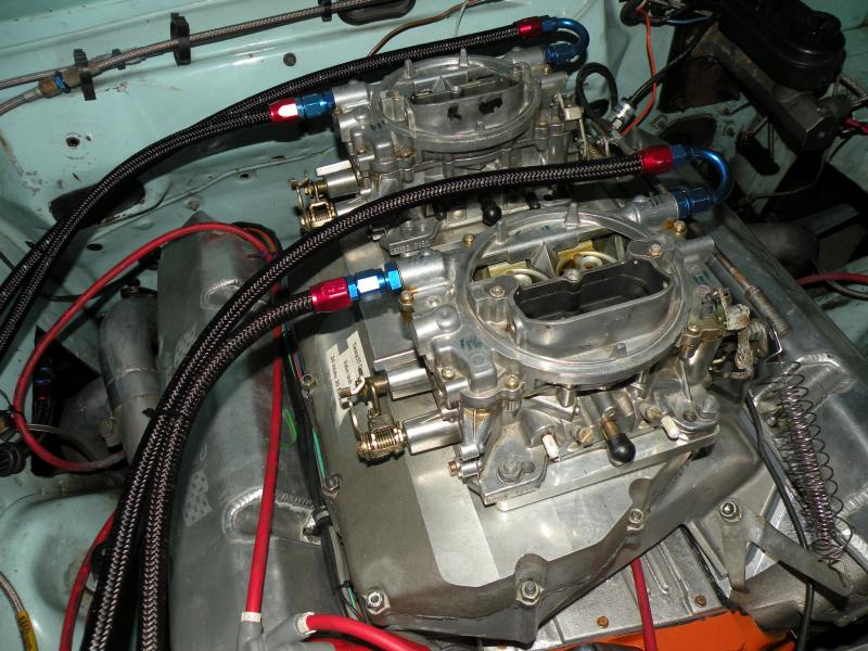

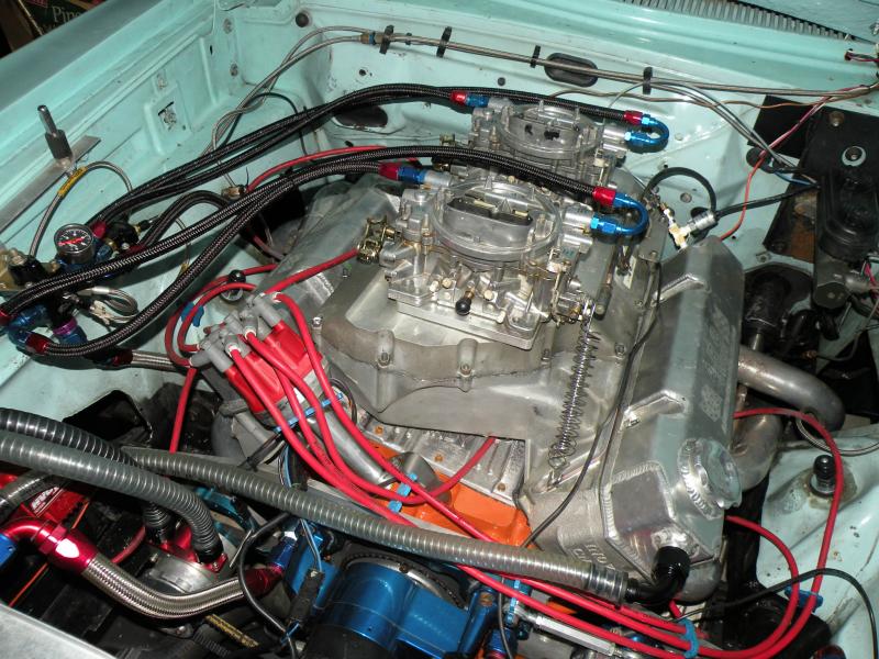

for dual carbs in conjunction with a hemi AFX hood scoop?
i'm pretty sure there are gains from trapping all the air in through a airpan with a small cutout in the rear to let out excess air trapped inside.
any thoughts?

yes im going to build an aluminum carb pan to trap all air going in from the afx hood scoop. i need a few more mph and .1-.1.5 et drop
just switched to a radial slick and need a little more. i want 150+ mph in the heat.

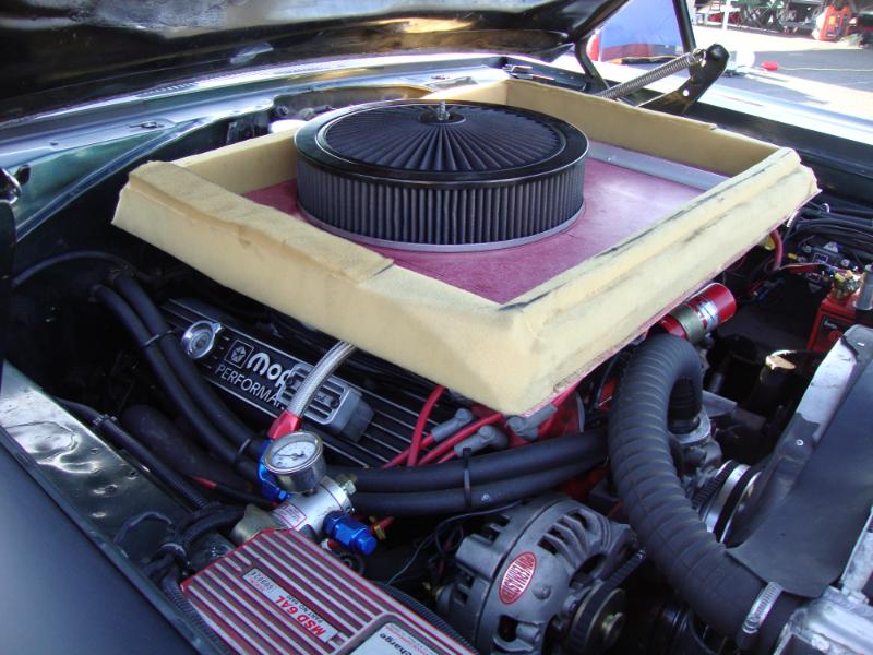

on my 440 the air pan i use made over 25RWHP on the chassis dyno.on all the cars i have fitted them they have gone 1/10th plus better.I try not to use aluminium or metal as a plate if possible,i have 3mm fibreglass sheet , marine exhaust heat shield on mine and have even used plywood . The metal plate especially aluminium in my opinion will pass too much heat , though if you do not drive it up to the lanes etc this would be less of a problem
just check to see if you need to rejet , more than likely
Tex
PS : i also used this pan modified on a modman dual quad manifold . This is under a sixpack hood
I sure learned by experience. I had a 71 Dart years ago. It was a really fun car. BONE stock 71 360 except cam, headers, MP electronic ignition, headers, hot 904 with a 2500 converter and 4.10 gears when at the track. A functional scoop allowed me to run 12.90s instead of 13 teens on slicks. I couldn't believe it made that big a difference. I just used on of them Moroso pans with a velocity stack screwed down on top of it stickin through and sealed to the hood into a Mopar pro scoop.
