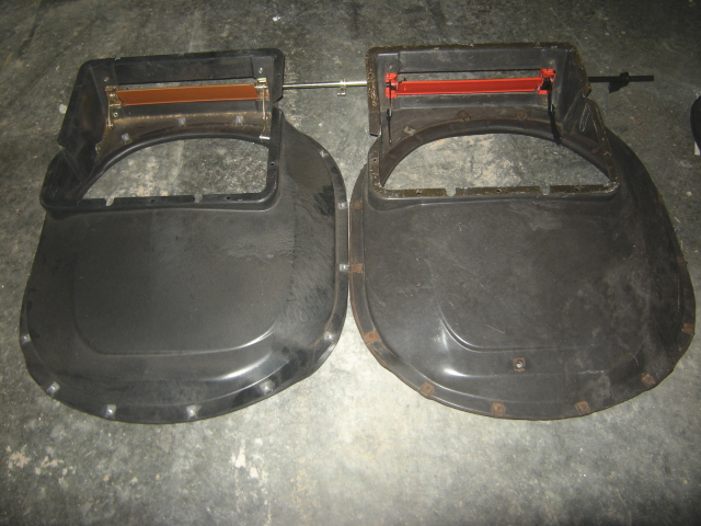

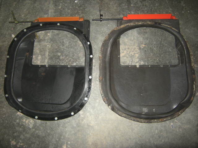

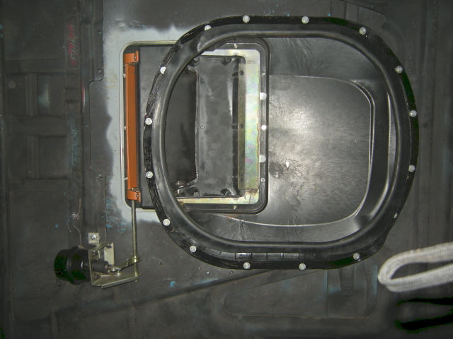

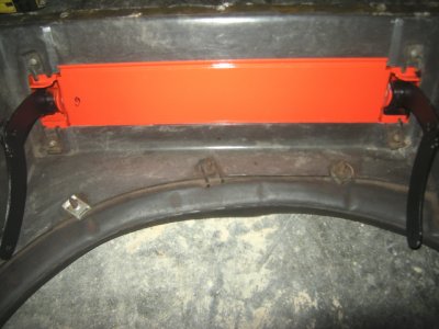

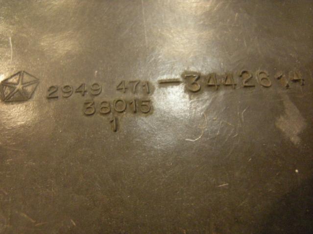

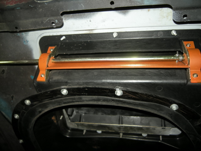

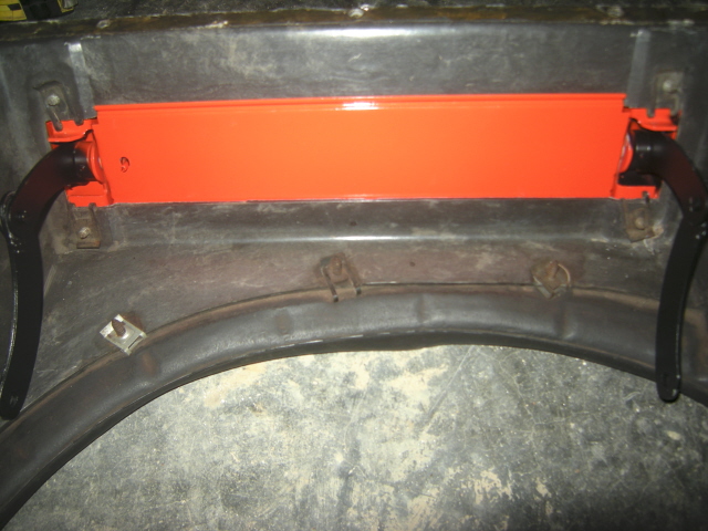

Here is an original and a reproduction. The one mounted to the hood and on the left in the other pictures is the reproduction. Very little difference. The door is held on with bolts and nuts rather than screws on the newer one. There is a slight visual difference in two corners of how the fiberglass was formed, but only very slight. Dimensionally measure out the same for width, screw holes etc. I do not however know what source the reproduction came from.

Those fotos are extremely helpful. There seems to be hope that a functioning Air Grabber can be fabricated with the parts now available. Now I only wish we knew what the source of the reproduction was!

Just in case you don't know, there are more parts needed than shown in the pictures above: You need a dash switch & bezel (I assume you would modify your dash), air grabber solenoid for under the dash, vacuum hoses, vacuum can for the firewall, intake air grabber vacuum fitting, air grabber hood, air grabber hood scoop, the air box, air box gasket, full linkage, vacuum actuator, engine base plate & Lid, and assorted small parts.
The full setup looks like about $1700 from Classic, plus your labor to actually install it, not to mention the balls to cut up a bulge hood.
