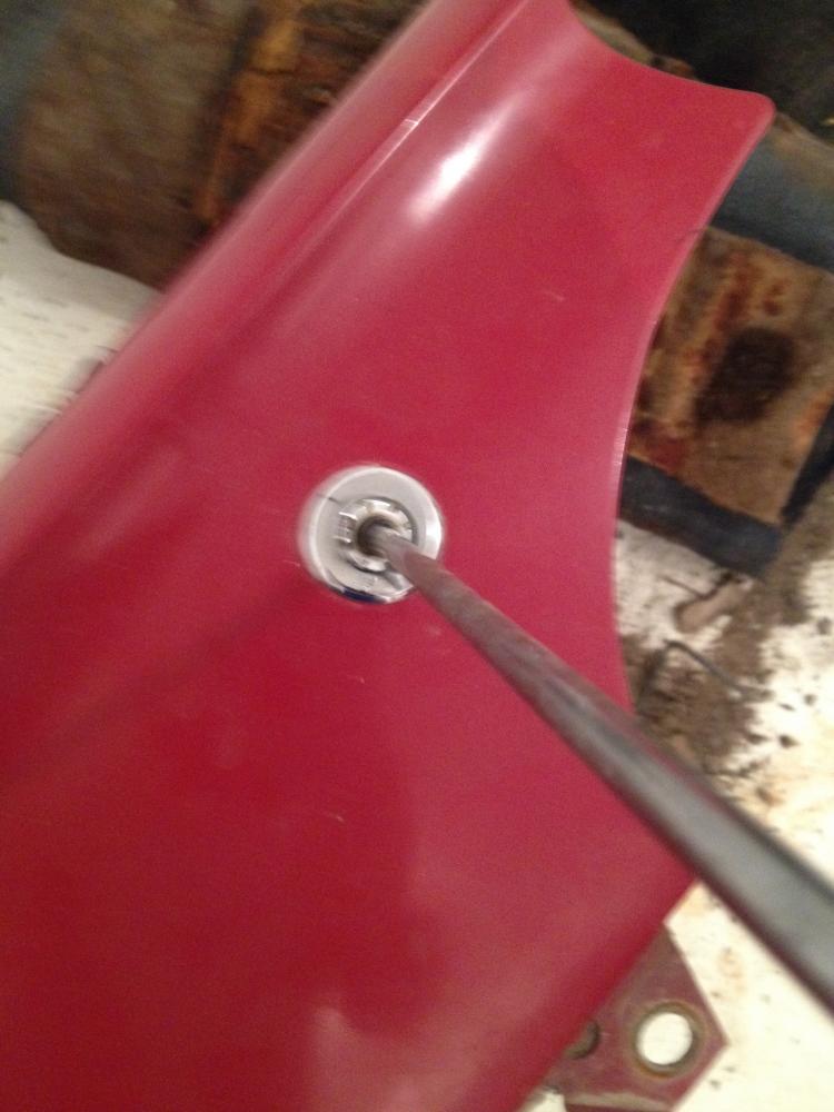

I tried whacking it a few times with a Screw Driver and a mallet to the Lefty Loosie on the Nut on top, but could not make it move. I must not have the correct application training. :). Any help will be appreciated.

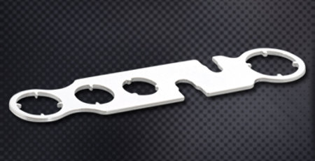

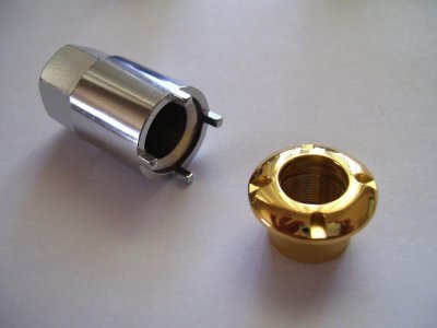

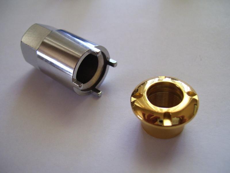

[video]https://www.jimsautoparts.com/antennas.htm[/video],, they make tools to take them off and when you cant get them off use vise grips or channel locks .
flip that fender over and spray some "panther piss" aka wd-40 or pb blaster on it. let sit overnite, then take that screwdriver to it again (gently)
I was going to suggest vise grips as well. Couldn't really tell how much nut there was to latch on to. Hope it works for you.
I used an oxy acetylene gas key to remove mine. Fits into the slots nicely if you happen to have an oxy acetylene set around.
