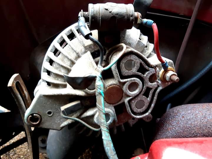

Someone sent me this picture. I have no idea where it came from or how he came by it, or even if it's real.

Back in the day ('50s) there were "doorknob" capacitors, that looked like each half of this monstrosity. That being said, a rectified signal (DC) comes from the alternator, so it cannot cross a capacitor. The capacitor can filter any ripple on the output, but that is to ground. Something I do notice is it looks to be missing one of the diodes by the output stud...

I've heard alternators make a heck of a noise through the speakers when you had the radio tuned to a AM station. It wasn't the plugs or plug wires doing it. This was a whining noise. A capacitor would normally fix it if there wasn't a bad ground causing it.
