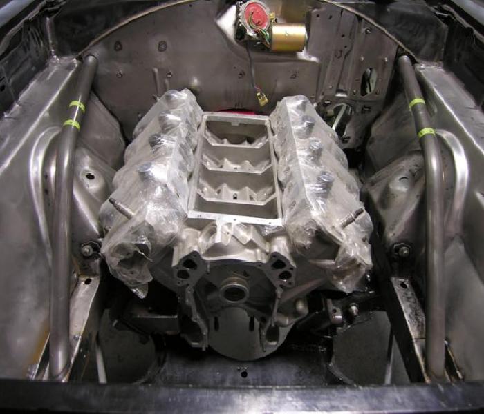

Found this build. I have not gone through it all yet but interesting
http://www.theturboforums.com/threads/322032-70-Challenger-572-c-i-106mm-turbo?

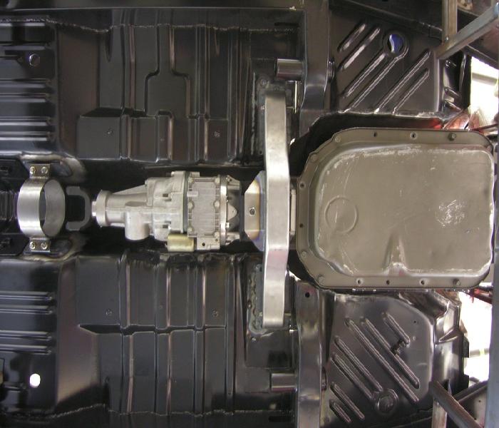

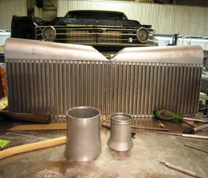

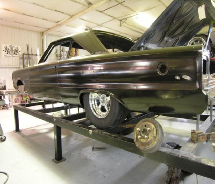

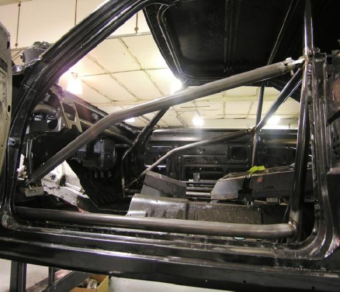

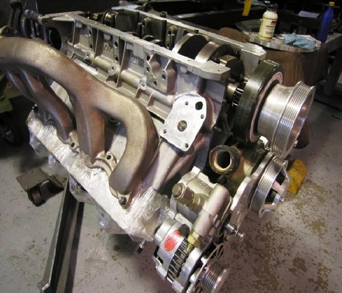

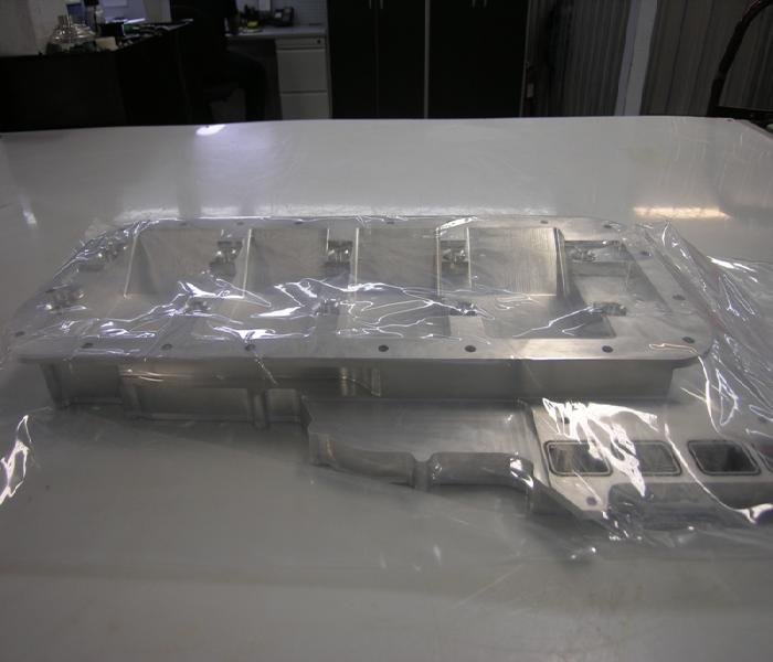

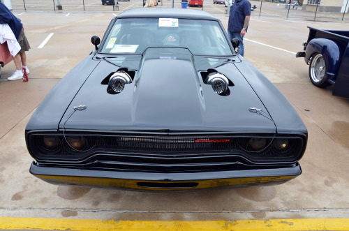

I have seen a couple rear mounted txt projects. Have a hard time believing that you can over come the turbo lag and keep boost as the pipe go up and back the length of the car. Good example of a log type manifold though. Thanks for the link
wow that was exactly what I was thinking of especially with the turbos sitting out of the hood. great find. would love to see the plumbing under the hood

looks like he probably reversed the manifold and ran in the intake from back to front through the firewall

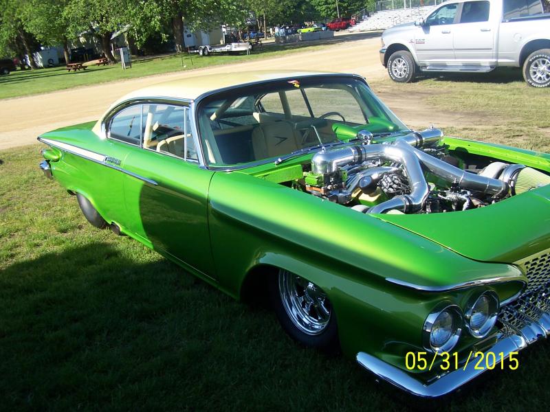

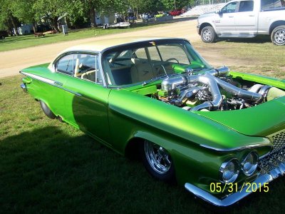

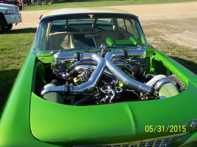

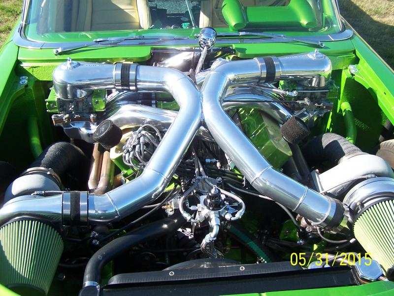

Here are a couple pics of a twin turbo / cross ram set up I saw at Mopars in the Park in Minnesota. Don't know the particulars but it was neat and drew a lot of attention. 100_6941.jpg100_6942.jpg100_6943.jpg
That's wild & using a {Cross-ram} long-ram/sonoramic-commando intake too
That is a sweet ride. Did you ever hear how many cubes it was? He made lots of laps with it during the show, didn't sound overly crazy, but I'm sure it makes plenty of power.
You must have taken those pictures early? I got some Saturday afternoon and had to wait in line. LOL
I took the pictures on Sunday morning before it got too busy. I didn't talk to the guy but I saw him drive it around on Saturday. Sounded healthy and seemed to start and run nice. Like you said, not overly crazy. I don't know anything about the engine or what it makes for power.

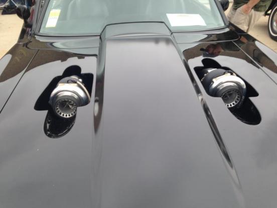

I hear ya on the turbos sticking out of the hood I think it's a cool look. When the time comes to move forward with my procharger setup if everything doesn't fit under I'm thinking I just may have a hole for the carb hat to poke out.
