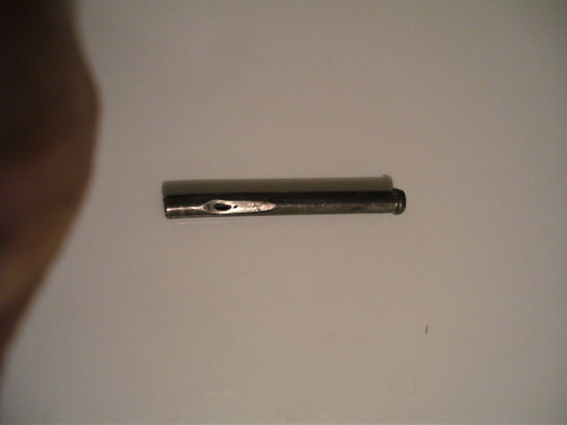

Found my problemm after plugs, wires,pickup,control box,fuel pump, and a new fuel filter, which is clear plastic , got it started and notice hardly little fuel running into clear plastic fuel filter. found hose from metal gas line which ends about under motor mount. This rubber hose was very soft, I could sqeeze it together with very little effort. replaced it, still hard to start. jack front up with motor running ad move metal gas line around were i connected the rubber hose, thought my clamp was not tight enough, and here is what i found. Hole wasn't that big until i took the buffer to it, this metal line had been rubbing on the K Frame for who know how long. believe I cured my problem, but was a bitch to find. Pain it the ***.

Wow... good find! That does sound like it was a PITA. Thanks for sharing the results of what you found. :sSig_goodjob:
