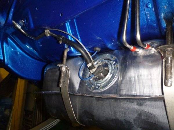

Been tryin to get my new tank to fit in right and it seems like the old straps just fit to loose and soppy, really hard to tighten up the screws at the front of tank, sockets not deep enough so lots of frustraition trying to get it tight enough with a open end wrench, had this thing on and off about four times now, and resorted to puttin some high density foam rubber on straps to make them fit tighter, anybody go through this? did u have to buy new straps to use with new tank or did you use your old ones.? also the shop manual shows a l shaped bracket on the filller tube, but mine doesnt have one? and my electrical connecting wire to the sending unit is missing in action as well? any ideas or suggestions???Thanks much!

I replaced mine and re used the original straps because they were in perfect comdition.Yes it is a PITA tightening them with an open end wrench but I got mine secure. I bought a new filler neck from Vansauto and it had the bracket on it as mine was missing also. It keeps the filler tube from rotating when tightening the cap.The sending unit wire comes off of the rear lights harness and is blue in color and just goes thru a rubber grommett just above the sending unit. Hope this helps
As red-runner said, look for the fuel tank sending unit wire inside the trunk coming off the tail light harness. The sending unit also needs to be grounded to the body of the car or (as in the factory unit) to the steel fuel line. I soldered a wire to the sending unit when it was out of the car and grounded it to the frame above the tank.

You can also take a piece of steel tubing the will fit over the long bolt, cut to length and paint to take up all that slack. Slide the tubing on before you put the nut on and you will not need near as deep a socket. The tubing also protects the threads from rocks and rusting, making it easier to get off at a later date.
