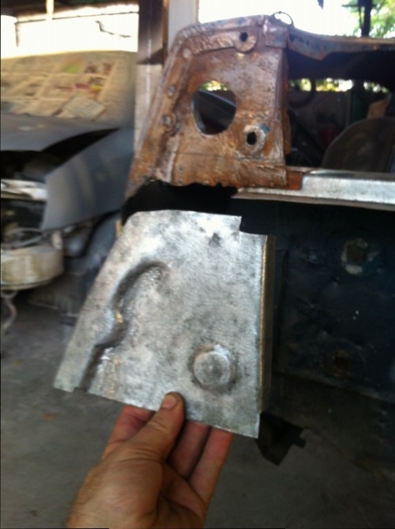

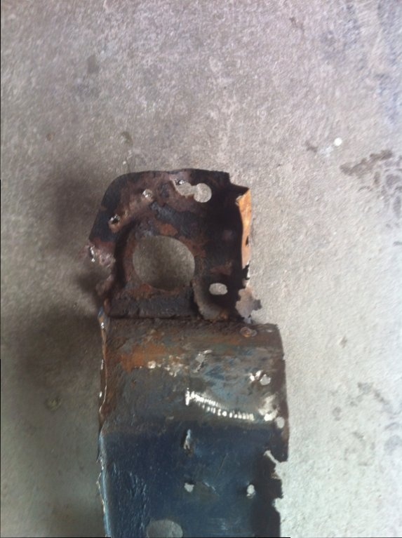

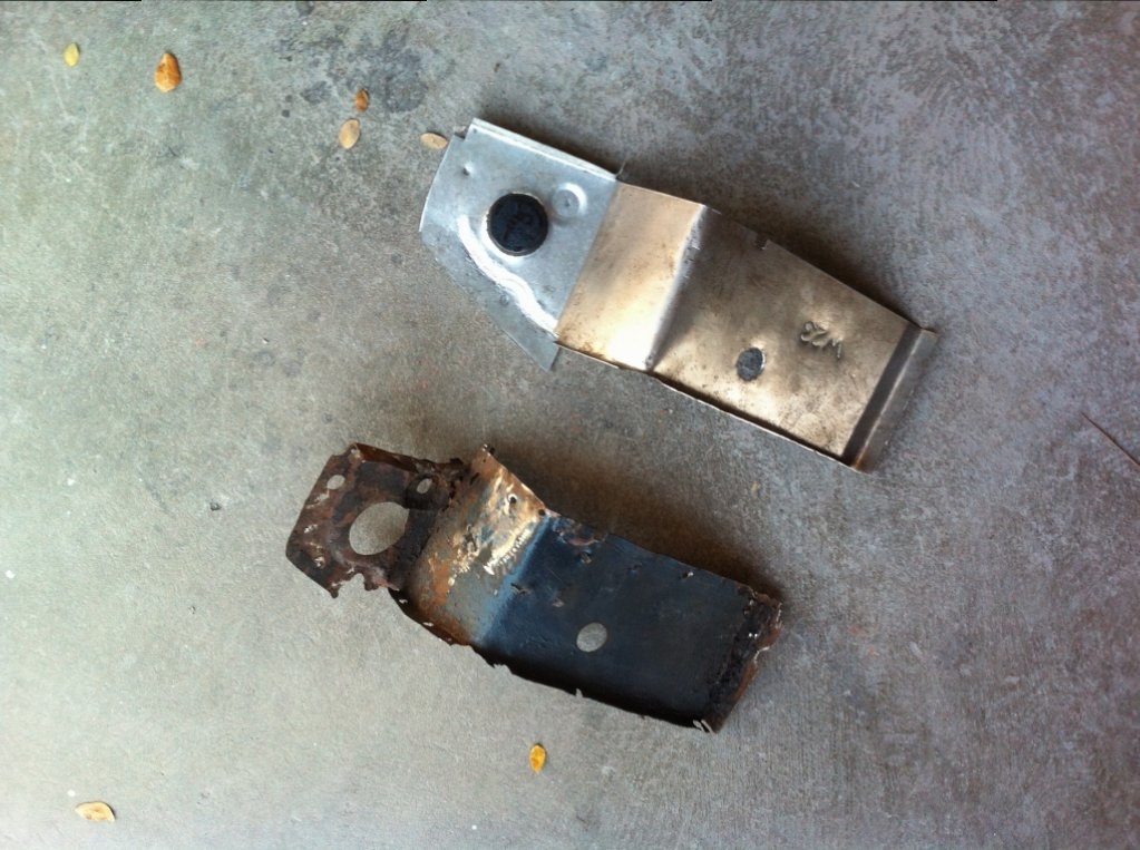

Found a couple of hard to reach rust areas on my 73 Charger, and I'm wondering if this is a common place to have rust. One big area of concern, is next to the trunk gutter, behind the quarter panel end cap. There's some rust holes on both sides of the car, and it's pretty much caged in and hard to access. Here's a picture, the only one I can find right now.
I don't really know the best way to attack this, as I'm not the kind of guy to cover up rust with fiberglass or bondo. I want to replace the steel.

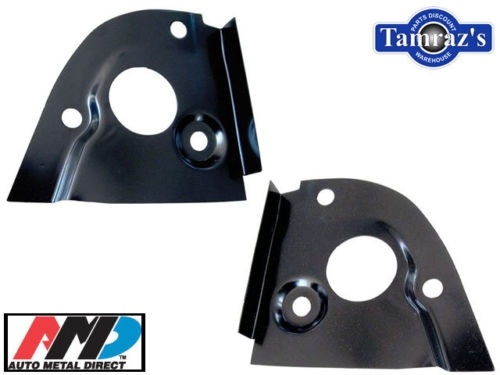

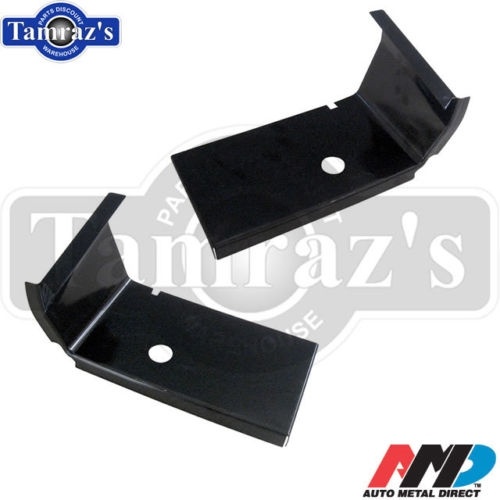

These are listed to fit a 71-2, but it looks nearly identical to a 73-4 part. Might need a little trimming... this would enable me to cut out the old piece, and weld in some new steel. But I wish there was a patch for the area that is rusty.
Is this the same part on my car that is rusty? It's hard to tell, but I bet it is. Just wanting to double check before I spend money and time fitting the wrong piece.

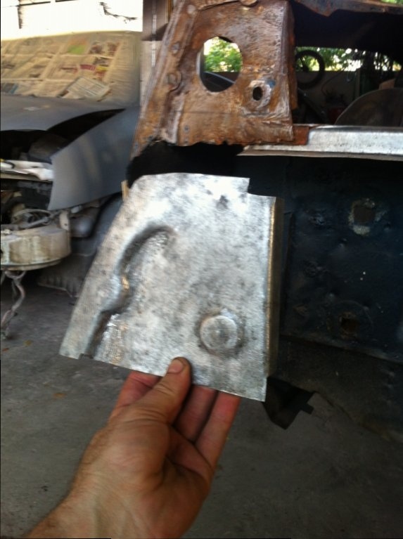

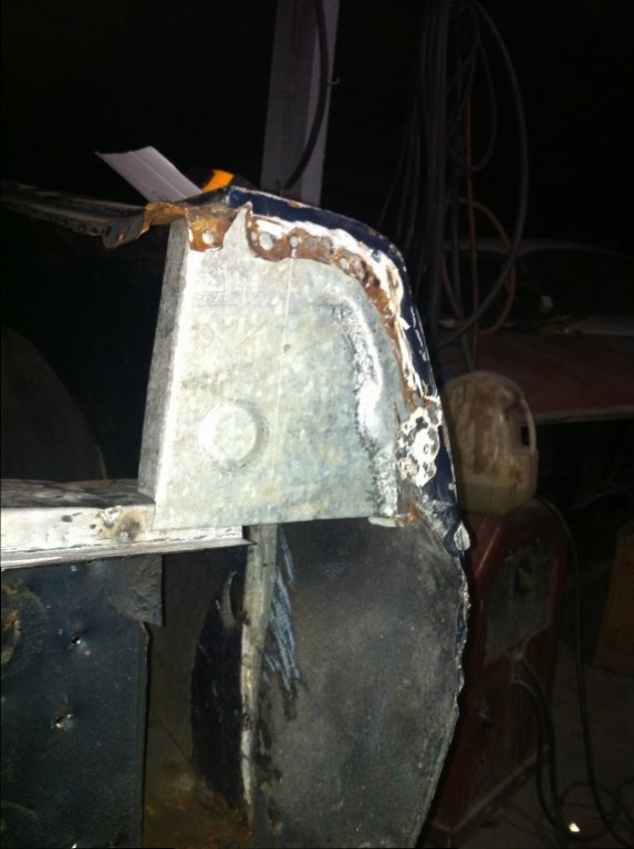

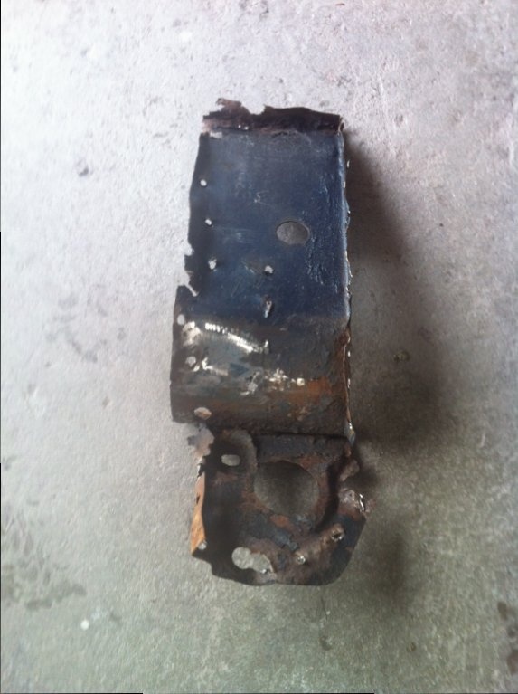

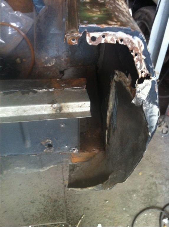

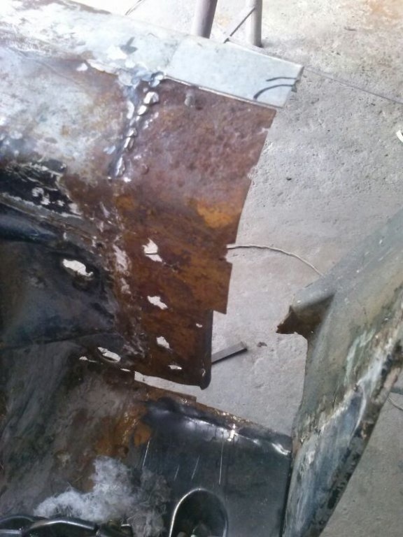

We made those pieces. The trunk rear panel extension CAN be the same between 71/72 and 73/74 BUT the section on back of the extension is definitelly diff.
The rear panel on trunk wasn't replaced even it looks rusted on the overlaped area with the extension, It was still "decent" to keep it there
Sorry, they can be uploaded in disorder.
I don't have pics finished but all that area is already rebuilt, including the new AMD trunk gutters, trunk floor extensions and locally made quarter panel skins
With the pieces of back of quarter extensions removed ( and new ones made ) you can notice how diff are from the 71/72

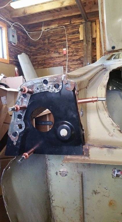

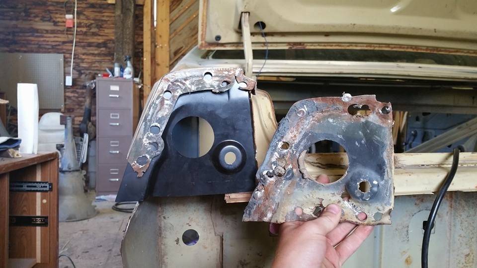

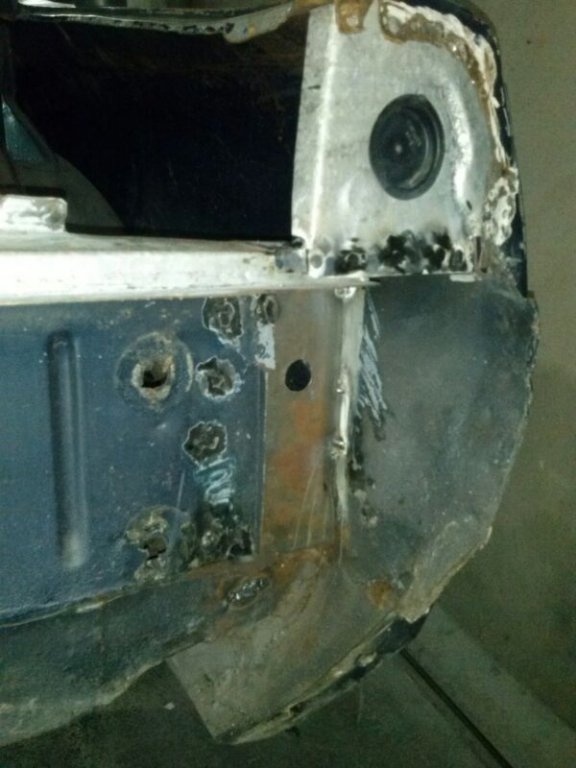

I thought I should give you guys an update. All parts I asked about, do in fact fit a 73-4 Charger. Except the trunk extension end piece support, which is easily modified to fit the 73-4. Here's picture I snapped. More to come soon.
