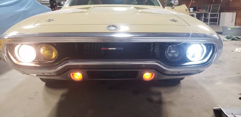

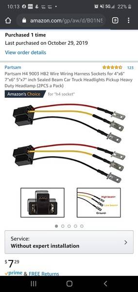

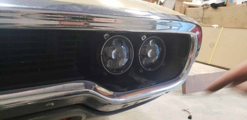

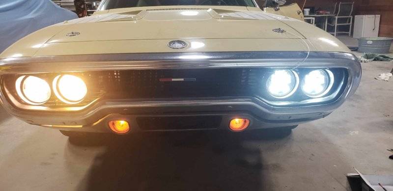

Just an fyi, I converted to H4 bulbs and relays more than a few years back.

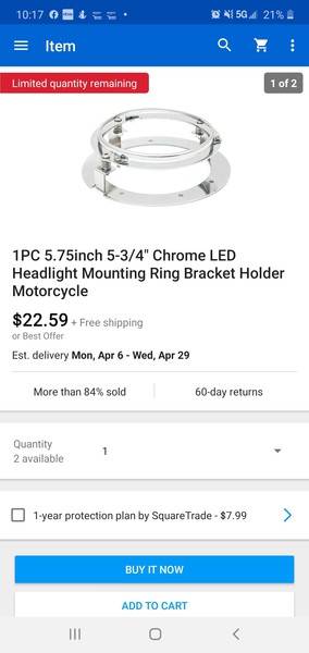

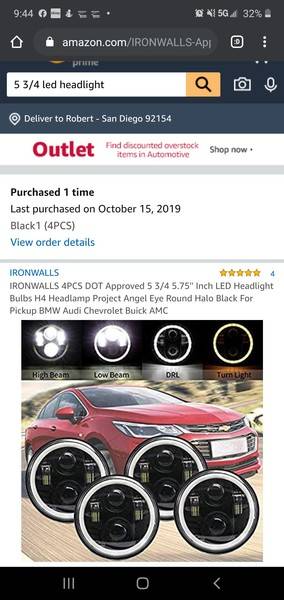

Iirc, I bought motorcycle headlights, they accept the H4.
Unlike regular sealed beam, they are flat on the front, but fit the headlight buckets and outer rings perfectly.
Bright as heck, even on low beam, and hard to tell from stock.

Mine are bosch, but exactly the same.
I got H4 bulbs on summit for like $20 on sale. They are blue, but the light is pure white.

I ran it with just low beams in it for a while, don't recall why exactly, but those were not as bright, so probably 50-60, but still bright as heck.
A huge upgrade from dim yellow light, with the same effort as changing a headlight. It's nice to see clearly, everything, and be seen.

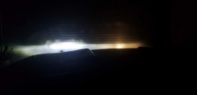

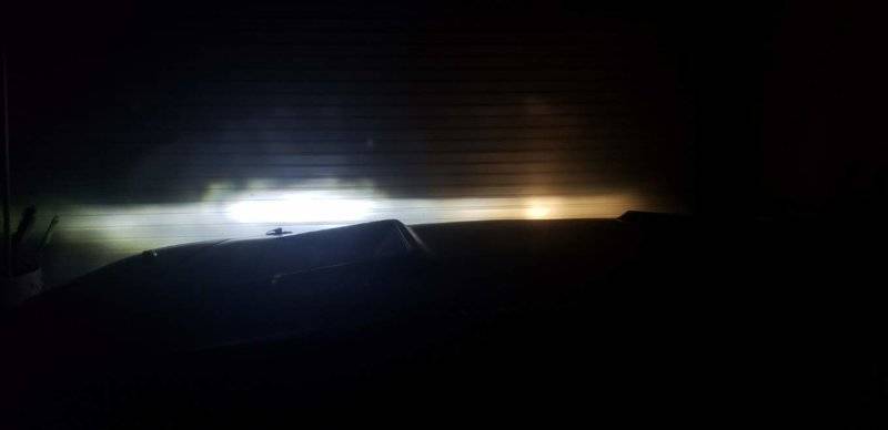

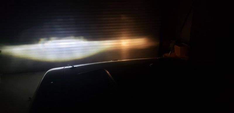

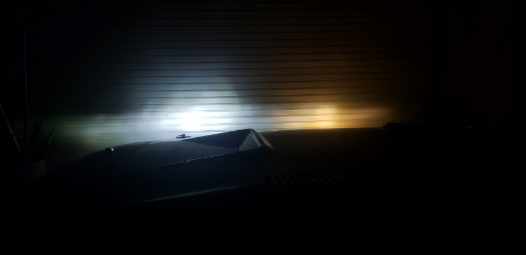

The headlights have a section on the right, when looking at the front, that keeps them from blinding oncoming traffic, can see it in pic.
