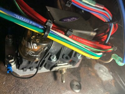

What is the switch on the bottom of this box for?
I would assume it's a master kill switch. But I have never seen it before.
That's what I thought too but I turned it off and the engine would still turn over.
Go to their website, it explains it. I have their kit but didn't think that switch was worth what they were charging for it.
I think it cuts power to the coil so the engine will turn over but won't fire.
Thanks.
Coil Kill Switch
